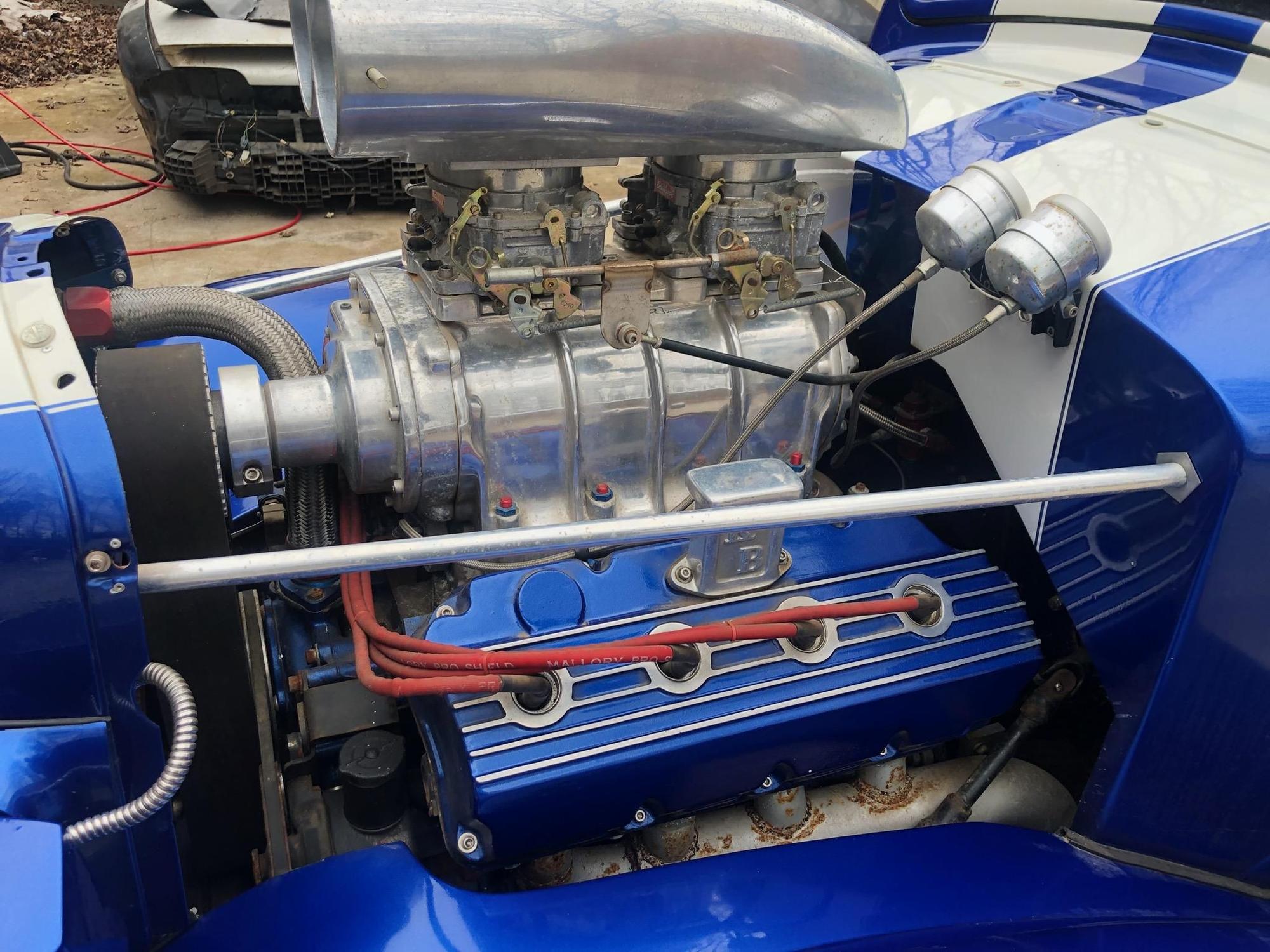

Not without pulling the fender's off I can't shift the motor forward. I'm going to try an post a picture of it for you

Might just be the angle, but I'm not seeing a problem. The blower assembly naturally has to come off, and once you pull the head bolts, you should be able to remove the heads.
Hardest part might be getting to the header bolts.
The real question might be, what caused the head to crack in the first place.

I guess I should have said we lifted the valve covers as far as we could to see the head but it won't come off all the way because of the cab. I'm assuming it froze because it sat in a open garage since 2012

I would be tempted to pull the motor and do a complete inspection. If it did freeze, there may be other cracks. I would have thought the block would crack before the head. I am wondering if the blower contributed to the head cracking. What else was done to the engine when they put the blower on?
