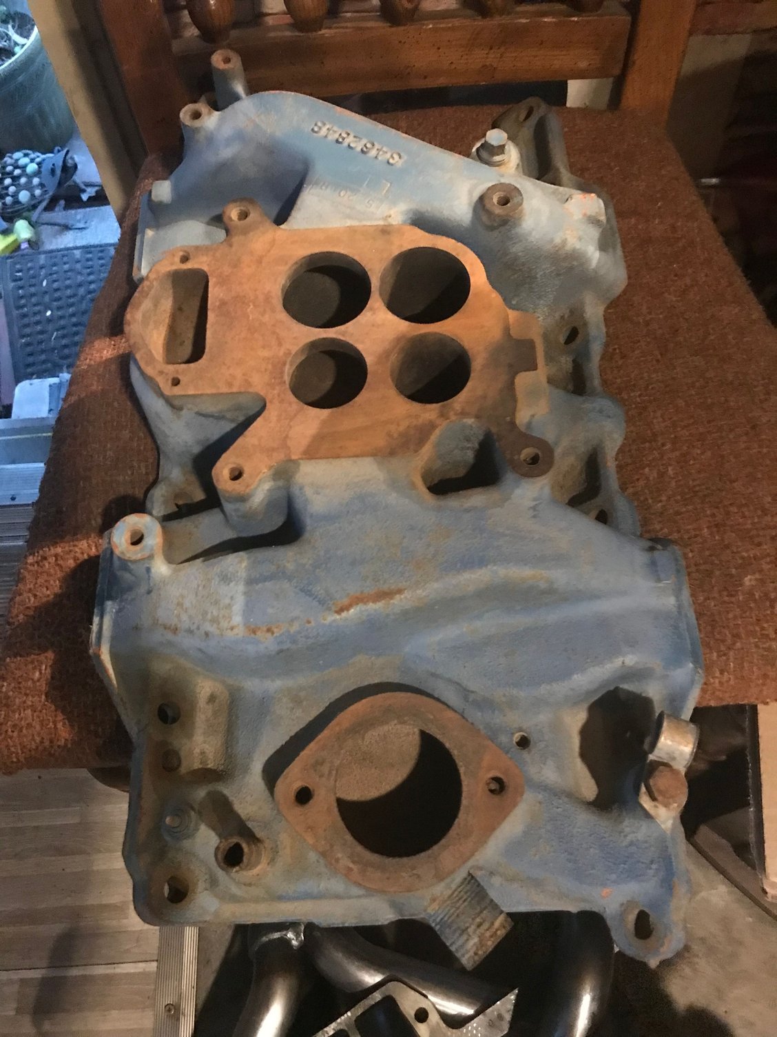

I am looking to put the correct carburetor on an intake manifold I bought. I was hoping someone could tell me if I should be looking for a specific carburetor? The manifold is off a 340 and going on my 72 318. Stock cam with hei ignition (if I can ever figure out the wiring) and headers Thanks for the advice in advance
Old Dec 29, 2021 | 08:03 PM
Carter or a Holley 4150 should bolt on without any issues....

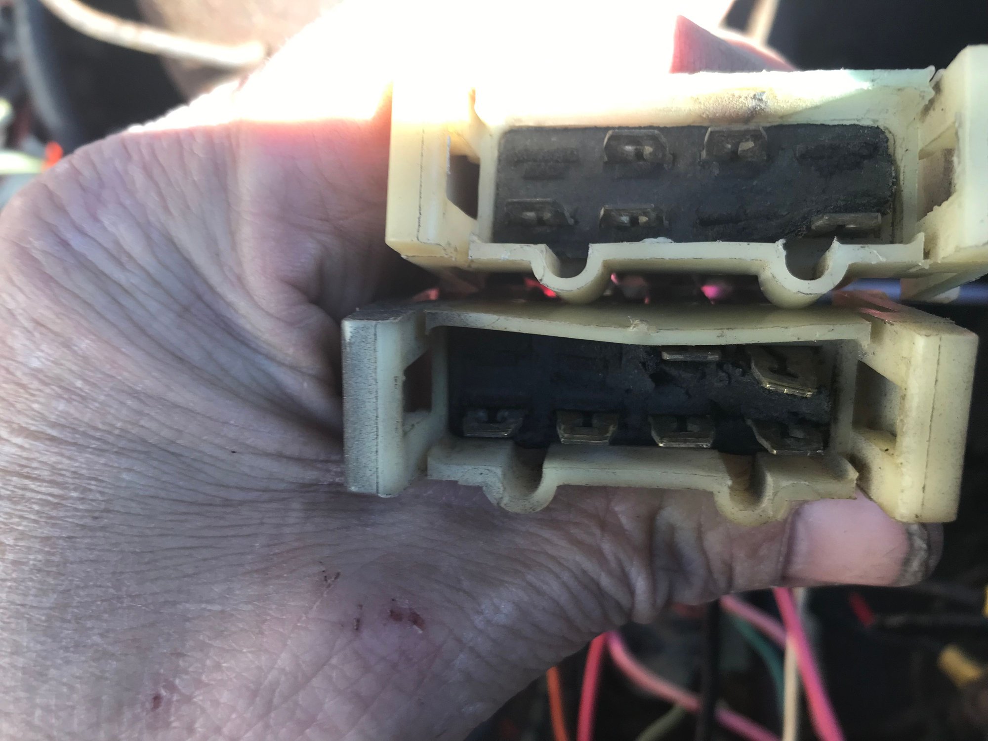

I spent some time today messing with it I have spark when I wired the coil directly to the battery but it doesn’t even try to start and the whole distributor wobbles when I crank it over. There is a reason it was only 55 dollars im not impressed at all the cap doesn’t even seem to fit tightly
Old Jan 2, 2022 | 08:35 AM
Are you sure you have the Distributor Seated all the way down in the pocket hold? If so, then I would check to see if the shaft is bent, Also now check under the cap and make sure nothing has been damaged?

Thanks I found part of the problem. The harness from a 74 had the plugs in different places then on my 72

That manifold is for a spread bore carb.

Thank you sir I have the adapter plate on the way
