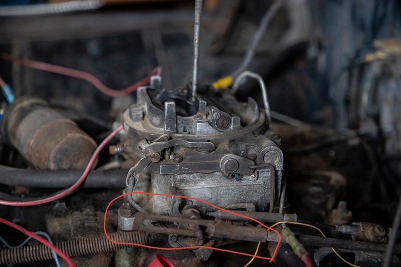

what ataches to this?
Old May 8, 2022 | 01:59 PM
1ajs's Avatar
Joined: May 2022
Posts: 11
got a 383 of some sort that has a linkage off the carb that goes down to the automatic trans (first auto anything ive owned) no idea what model. thats loose at the carb end
no idea how it is tied in properly. very green when looking at v8's
this is a 62 international travelette truck someone swaped this into almost 40yrs ago
engin runs fine as far as i can tell fixed what caused it to stall in this (electrical related)

1 -
If it's going from the carb throttle linkage to an ear (lever) on the automatic transmission, it's the "kick-down" linkage that gives you the passing gear. BUT it also regulates the pressures in the transmission, don't drive the car with out it (unless you go to a manual valve body of course ).

Old May 9, 2022 | 07:11 AM
Archer's Avatar
Posts: 1,889
Likes: 170
From: Long Island, NY
1 -
See if this helps, if not, take it to a transmission shop.

Old May 9, 2022 | 07:51 AM
looks hooked up to me.
Old May 9, 2022 | 07:58 AM
1ajs's Avatar
Joined: May 2022
Posts: 11
theres nothing to lock it in or anything?
Old May 9, 2022 | 08:04 AM
nope lol, they pretty much just sit there like that.
Old May 9, 2022 | 08:09 AM
1ajs's Avatar
Joined: May 2022
Posts: 11
was wondering if theres something to stop it from poping off
but ok weird
Old May 9, 2022 | 08:14 AM
oh i see. yeah there's a little thing that goes there and the spring keeps it on, too. sorry, it's early lol!
can't get images to work this morning, but google "mopar kickdown" and check it out, you'll see.
Old May 9, 2022 | 08:39 AM
1ajs's Avatar
Joined: May 2022
Posts: 11
txs that helps explain a mystry spring i found as well
cab was strewn with random parts i put in a tub
yeah, little things like this are odd and all over mopars lol. took me a while to dial in my kickdown, but they work.

The carb end is hooked up. The other end of the cable goes to the kickdown lever on the transmission.
Take the car out and cruise at highway speed.
Press the accelerator pedal (safely), if you drop into second (passing) gear and accelerate, it's hooked up correctly.
You can google 727 kickdown linkage for pictures.
Archer
Old May 9, 2022 | 08:00 PM
Posts: 5,482
Likes: 553
The way I’ve done it in the past is at wide open throttle the arm in the transmission should be all the way back, the rod should be pushing the lever on the transmission to its fullest, the length adjustment is on the transmission end of the rod..
On the carb there should be a hole for a cotter pin for a washer.

Old May 10, 2022 | 02:18 PM
Posts: 11,096
Likes: 955
Old May 10, 2022 | 02:21 PM
that's the photo i kept trying to put here but it wouldn't take lol!
Old May 10, 2022 | 02:22 PM
Posts: 11,096
Likes: 955
Old May 10, 2022 | 02:24 PM
Posts: 11,096
Likes: 955
If this dont help... Take a few more photos and will get you in the rite direction.... Cheers
And just to support what was already said. Dont drive it with out the T.V. Linkage. It will burn up the clutches inside the transmission.
