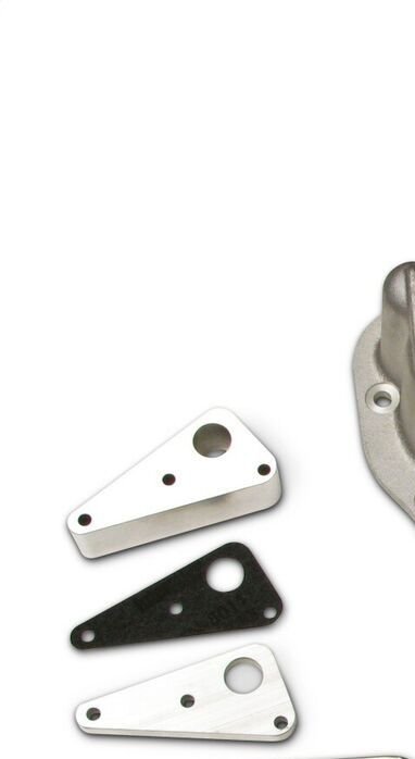

Hi guys, I need some advice. I replaced the oil pan on the 727 torqflite transmission, used the recommended 1 1/4" spacer, new filter, there is enough oil, but since the replacement, the transmission refuses to engage 3rd gear. Does anyone have experience with what or what it could be? Thanks for the tips! I read somewhere that you need to use both spacers at the same time, but I don't know. What do you think about it?

What oil pan kit did you use? Could you provide a part number or product page link?

Pulled and all things are in place. When driving to the service station, the transmission was fine. I used a B&M kit for 727 torqflite transmissions.

For example, On your kit I would have cleaned the spacer and new pan with brake clean and dried them with compressed air. I don't use cloths or shop rags they leave lent.
On the gasket that goes between the spacer and valve body did you install it dry (no sealants)?
