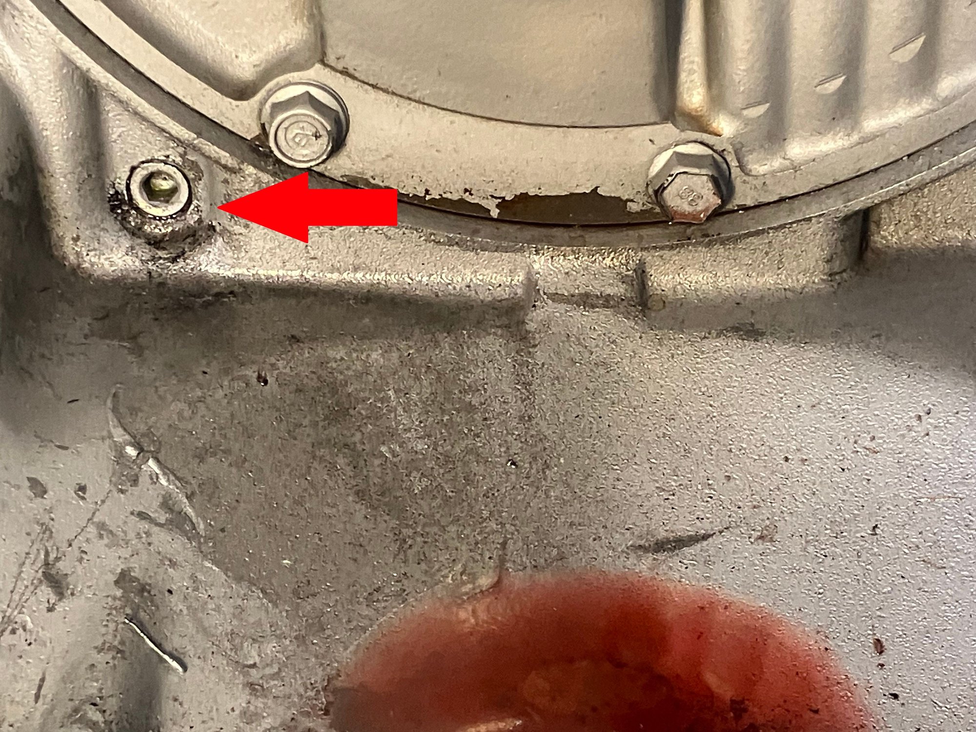

Anyone know what this plug is inside the bell housing just below the pump cover? Just pulled the pump to replace seals and noticed this plug which also looks to be leaking.

Front servo lever pivot access plug.

Many thanks.
