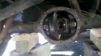

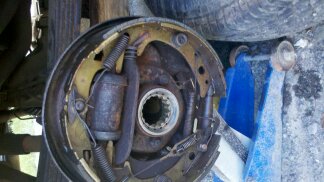

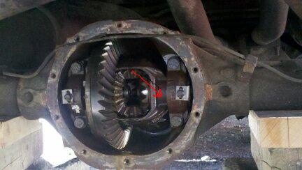

Here is my set up. Can you guys tell me what rear this is?

You'll want to measure the backlash before removing anything in the diff as you'd have to set it back up to that spec. Since the axle is an 8.25, you'll need a special spanner tool that slides in from the end and back off the backlash adjustment nuts on either side of the bearings.
Once everything is out, you'll need a clam-style bearing puller or a press to remove the old bearings. You'll need the inner race and either a press or a hammer to install the new bearings.
Old Aug 7, 2012 | 03:45 PM
Here is a video of a 9.25 which at. 10 minutes shows what he is talking about. I made two out of large hex bolts filed to fit and welded to pipe. If you had a tool you could try and tighten it to take slack out as a temporary thing but from what you described it sounds like someone before you has patched up problems already. Not looking real good in my opinion.

I notice that the right side bearing nut that adjust in and out for the bearing was way out so I inserted a tool I borrow from my friend and adjusted both side bearing and this eliminated the wobbling in the ring gear assembly. Well I installed the new bearing and seal to find out that the wobble cause wear on the shaft and the passenger side axle can be moved by hand. I put oil and was leaking. So I am starting to look for a complete diff 8.25 with 3.55 ratio. Thanks a lot guys for all the info.

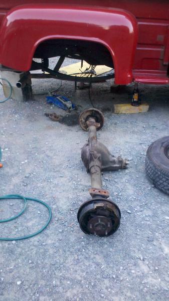

Well, I got home from work and decided to take out the rear axle. Took me about an hour and one half. I figure if I can get a axle in good shape, I wont have to mess with this axle braking latter on. I hear about getting a new tube but even the gears are shew up. There is an axle in Connecticut and they are asking 275. I will look around before I make the trip.
