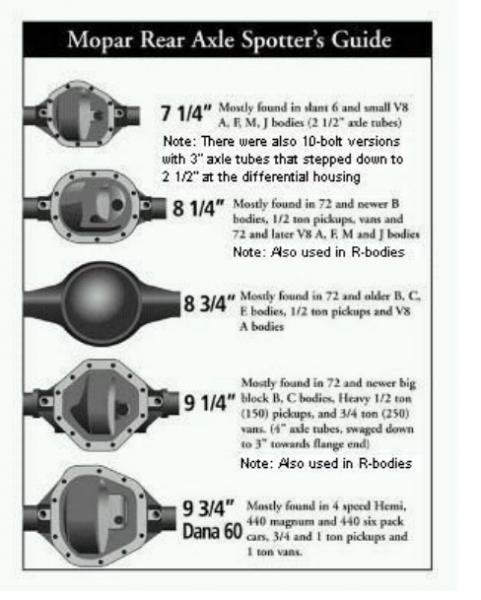

sfort -
Post a picture of the rear, it should be readily identifiable. See the attached pic.
As for the gear ratio, to may have to test it, since there's no way of knowing if it's stock or not. Fairly simple to ratio the times the drive shaft rotates to the number of times a wheel rotates.

Yes it's a car I am going to buy. It does have the rear seat in it I will look there. The car was a Rally 340 1-4bbl engine with a torqueflight transmission. Since I am going back over to look under the back seat I will look at the rear end to make sure it is an 8 3/4. I want to make sure what gears and wether or not it is a posi as well.

It's a 8 3/4 rear end. Have to figure out the ratio next.

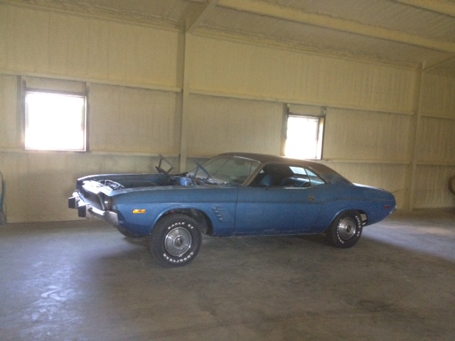

We bought it!
Here is a pic of the car. Other than some performance upgrades I am thinking as stock as possible.

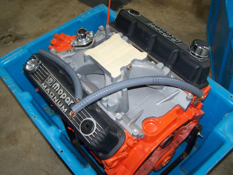

Finally got a pic
I think I finally got a picture to down load!
Old Oct 20, 2012 | 10:09 PM
  #26
Easiest is to stick with a carb !! Or switch to an Eldebrock / Holly system for fuel injection. The trans can be made to work, You will have to modify the trans mount, shorten the driveshaft, and adapt the computer
