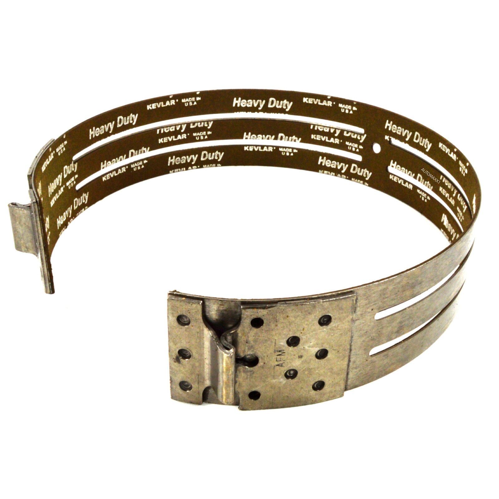

The weak or vulnerable part of these transmissions is the reverse band ear. While in drive you suddenly or quickly shift into reverse or the number 1 culprit throwing it into reverse on high idle after a cold start. I keep my cold start idle lower than recommended in an attempt to eliminate that sudden snap in reverse.
