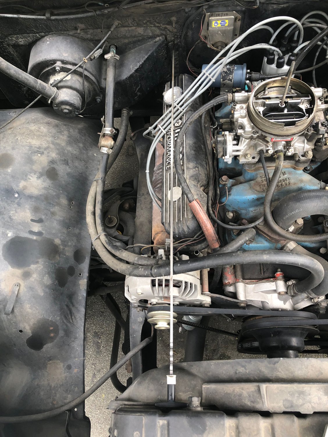

2. The engine did not come with a a dipstick, nor dipstick tube. I managed to have a couple lying around, but I do not know which combination works. I put 5L of oil in and it is not registering on the dipstick so I believe this is the issue.
Would anyone be able to take measurements of both items on a similar vehicle? Has to be a truck oilpan.

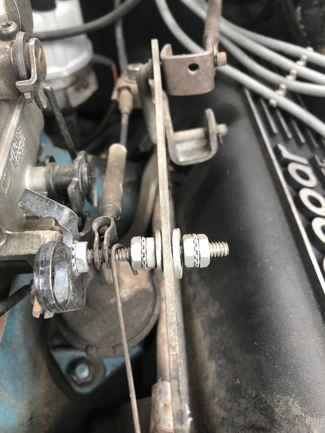

For fun here is a picture of my "ingenious" throttle/kick down linkage setup.

Hey, If a Zip Tie is not involved, its not a Dodge!
Old Apr 5, 2019 | 11:10 AM
I thought it was mechanics wire and twine to be a Dodge? Add duct tape if your going to race it.

Sound like it has the truck pan (Rear Sump) on it. 7Qts if i remember correctly. You just need the dip stick for the truck rear sump oil pan.
Glad you found the issue..
I dont use that large of a stud. I use a 1/4-20 long screw with a few more flat washers and nut (To Jam Nut them) and and assemble the unit.

Picture of the dip stick... runs from the firewall to the radiator. I didn’t have a tape measure with no. But that should give you an idea.

This is how I do it with a 1/4-20 screw
