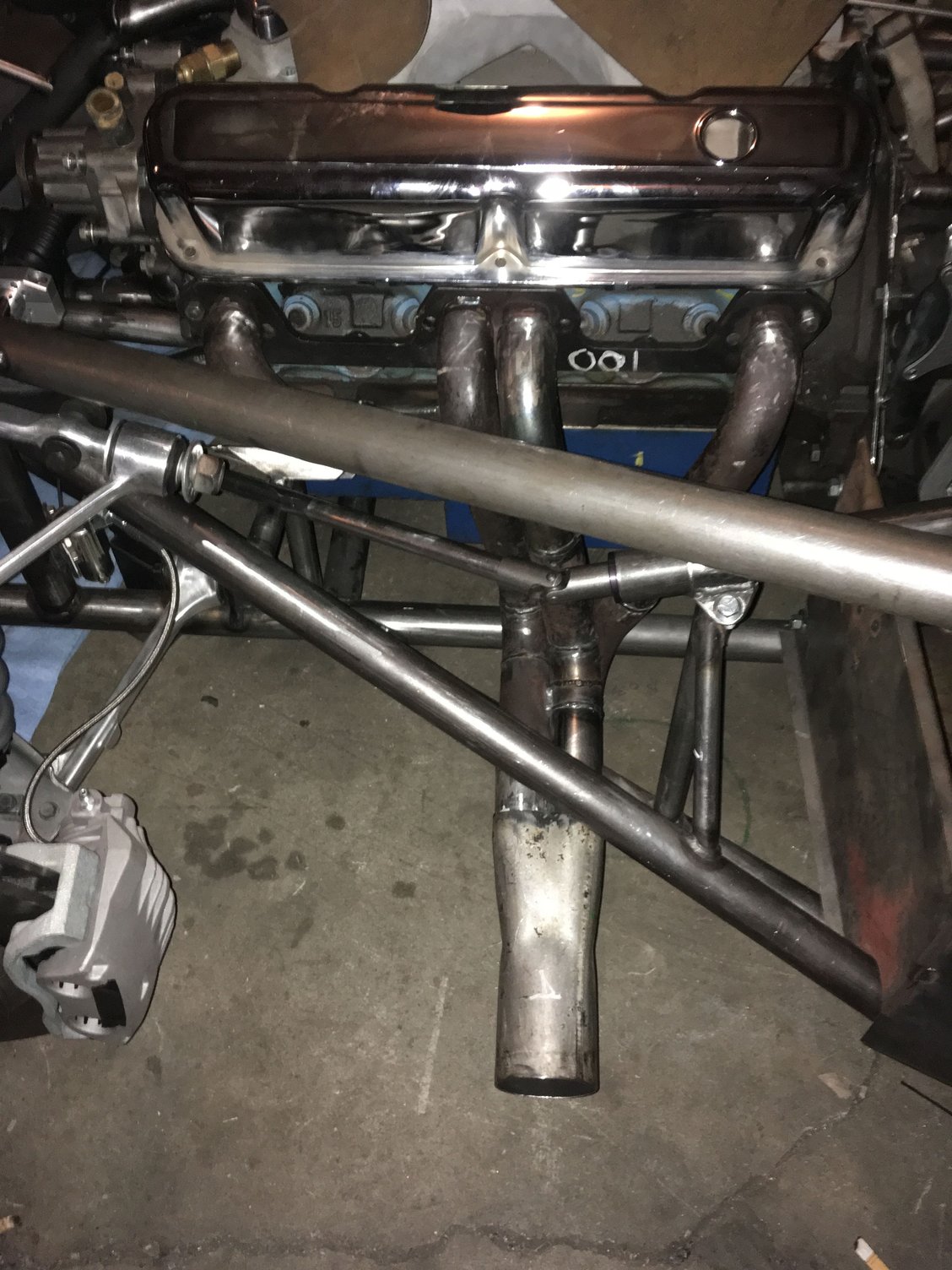

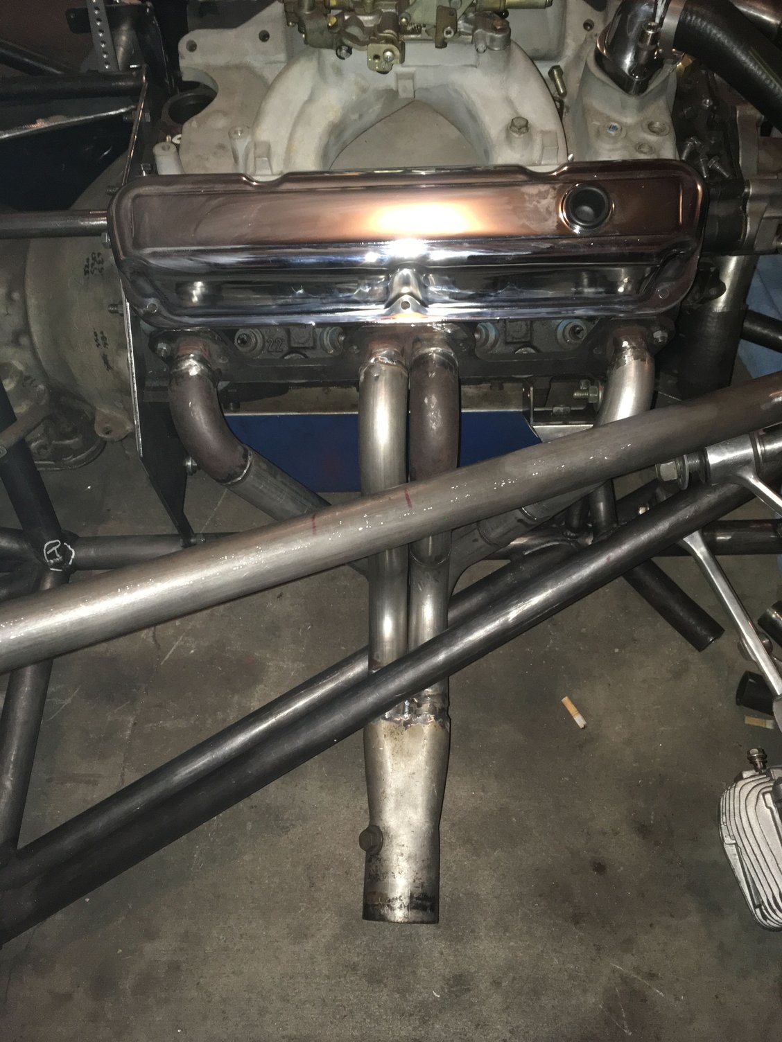

Made up one pipe yesterday out of a bunch of stuff, too many joints.

Other pipe done on the cheap.
Old Apr 26, 2019 | 06:00 PM
  #125
Posts: 5,467
Likes: 548
What size tube?
Old Apr 26, 2019 | 08:23 PM
  #126
1 3/4" O.D.

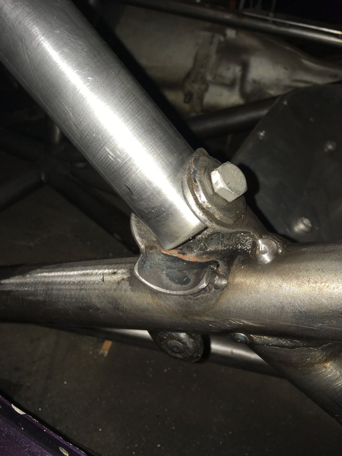

Steering Shaft - Yes, additional 3/4 rod end going on down near rack. Starting to get busy in front, having trouble routing fuel line, filter and pump. We'll get it but it's like genius idea then oh that's in the way of the other thing and we have to find a spot for the other other thing. Everything looks good on paper or in thought until you put it together and conflicts arise. Normal.

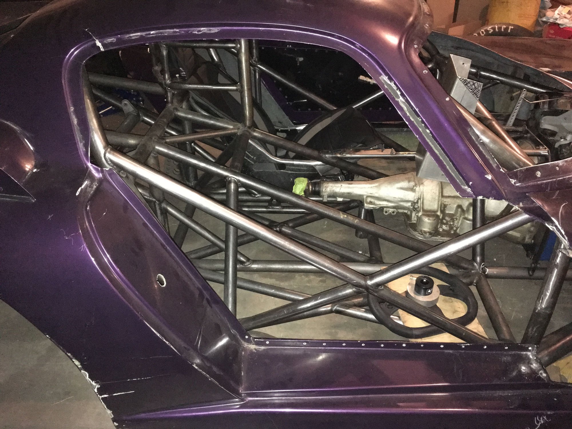

It’s nice the way tube placement fits the door without having the car when building it. We talked about it and to start the rear wing will come off and the 14” extended front end will be cut down to stock length to have stock wheelbase. I need to make an expected alteration to the A pillar tube as it has a bend that matched the Corvette. I’ll need to redo the wishbone and anti-roll bar mounts which is not a big deal. Biggest thing is tipping the four link mounts forward to match the shorter four link bar mounting hole radius. So a little more fun for me. I sat in the car with the body on and it’s real cozy in there.

Got the body mocked up and ready to add permanent mounting and proper door hinges and latches. I will be cutting out the long X brace in the back as it’s not needed with moving the shock mounts forward. Had to do some wango tango at the A pillar as the Viper is different than the Corvette. Cut out part of the drivers X to swing it out for easier in and out. Looks like I can get a 42” wheelwell in the back. Shawn says he wants to paint it gold with black stripes or candy red.

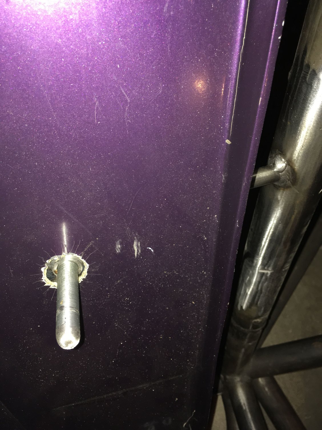

Thanks, never thought of the sponsorship in that way, it will be unique and probably draw attention. Made up some door latches, Shawn was so happy he gave me a hug, a little unexpected for this Dad but nice.
