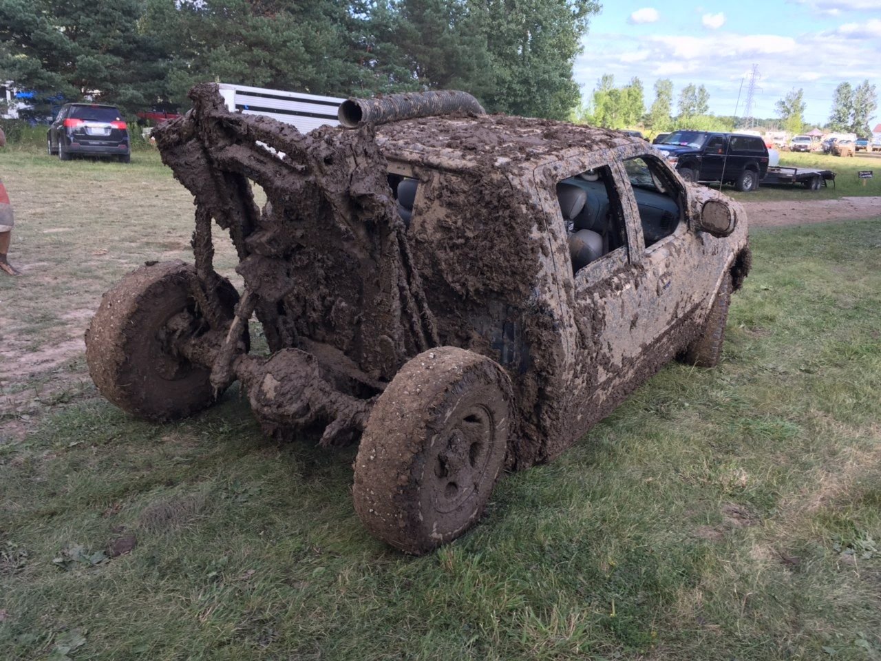

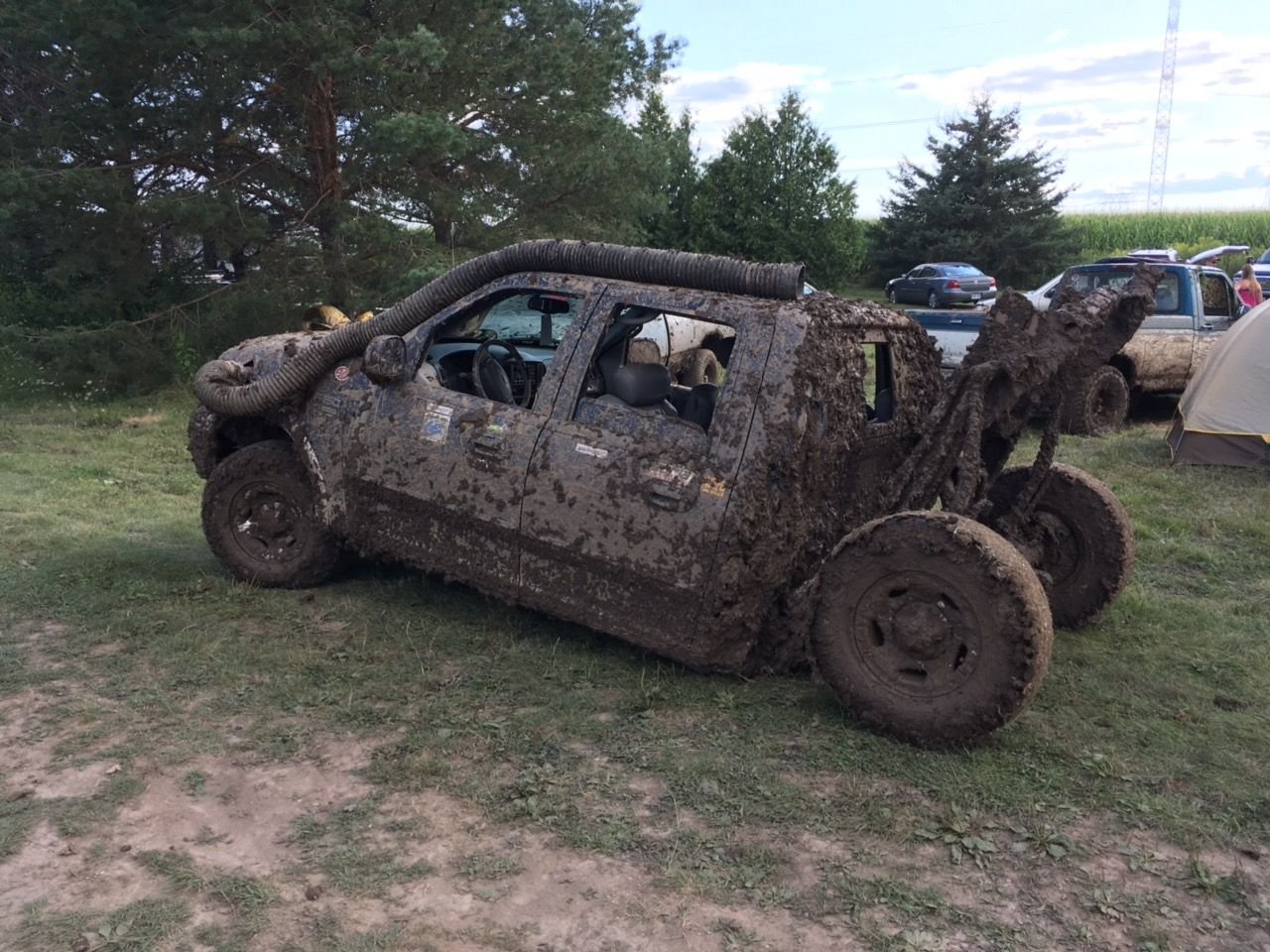

Not much on the car, boys have been out breaking stuff.

Just what the hell is that? Looks like a broke exploder and mud.

4 wheel drive Ford pick up without the box. Frame broke just behind cab, rear wheels were still turning until the driveshaft broke. Steve said it was still moving forward with the front wheels only until the driveshaft broke, beat up the gas tank, smashed the fuel pump which stopped the engine. Steve said he thinks if the engine didn't stop the front wheels might have pulled him out of the hole he was in with the momentum he had. It was a local mud run.

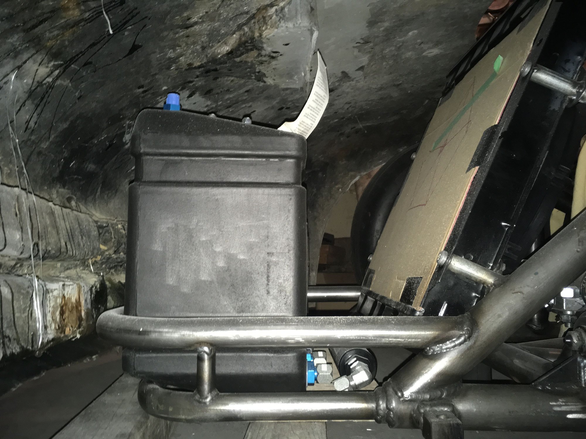

A spot for fuel tank, filter and pump. Mounting front end next.

Pop the wall nose first and throw fuel over your small block. I've never liked them in the trunk either.

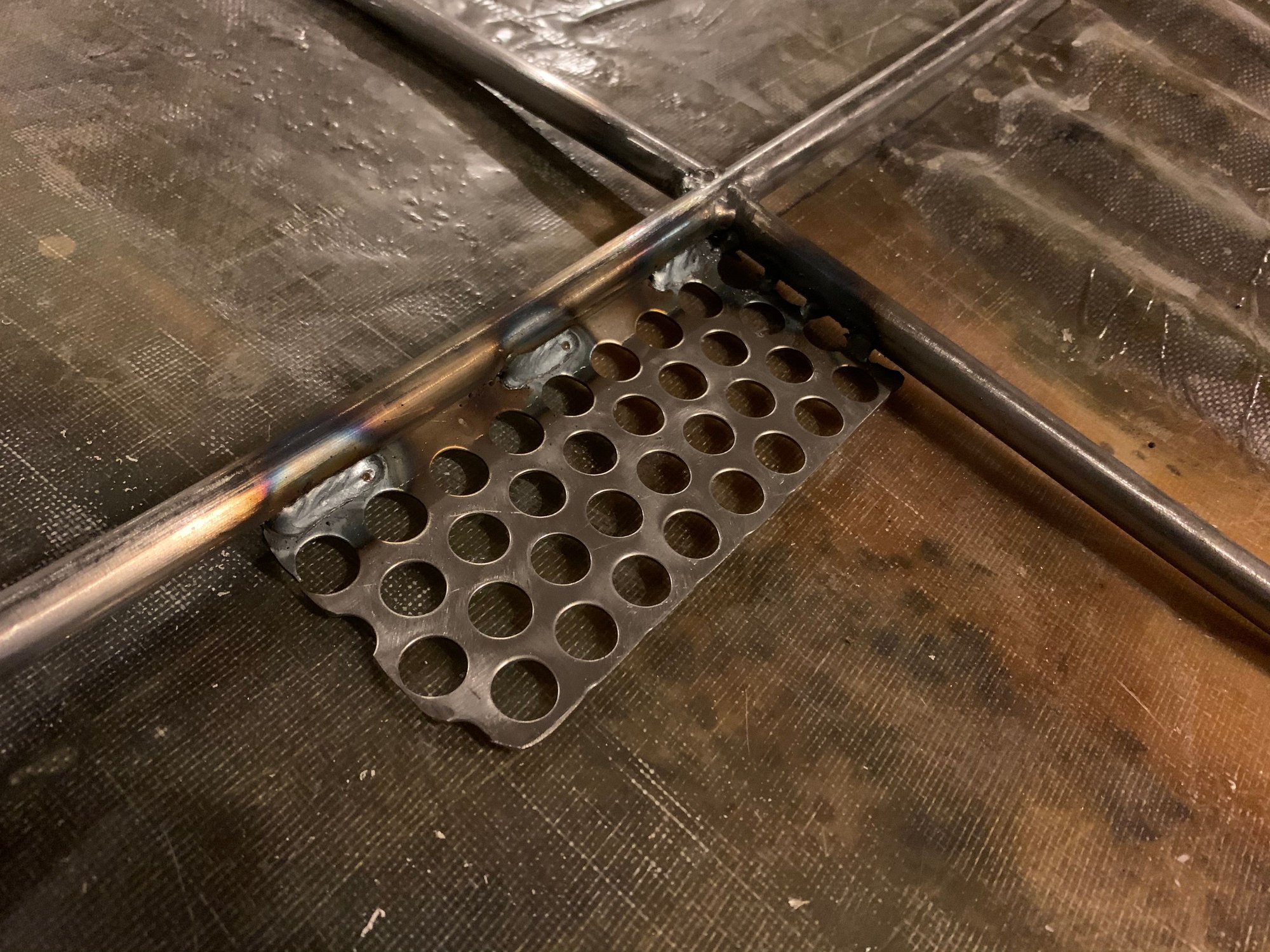

The 1/2” tube frame, after removal for painting the perforated plates will be epoxied to the front end then fiber glassed over.
