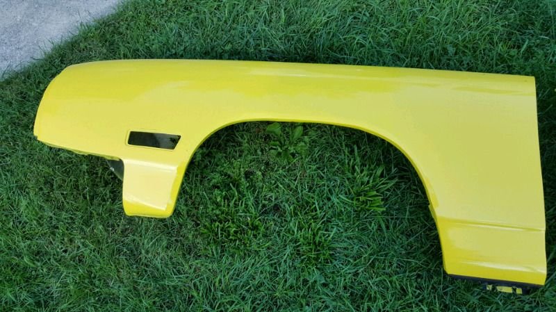

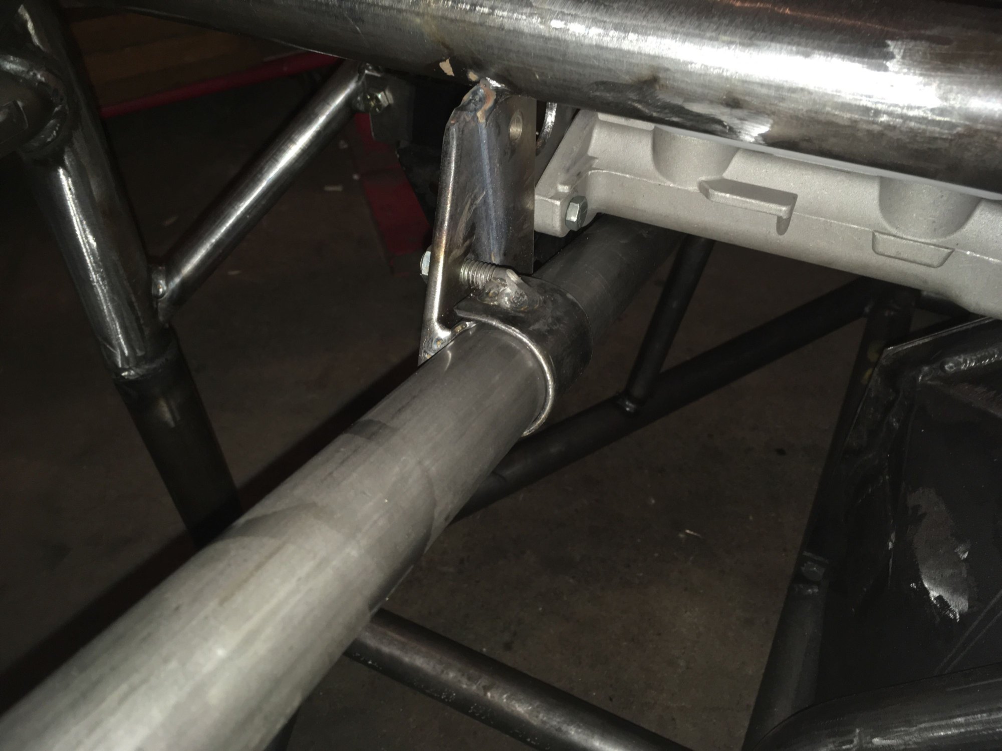

Made these tabs from 1 x 1 1/8” drilled 7/16” to accept the free casters Shawn got from his boss. He can move it around to bring the snowmobiles in to work on. I’ll leave them for future use when the car is complete. Nothing significant has been done just brake mount and some little stuff. Received the steering shaft kit from Bear’s which is all chromoly with aluminum bushings. I’ll need to bring the Tig machine home now so I can weld it the 4 link bars, wishbone and anti-roll bar. Shawn has picked up a nice gauge package, steering wheel and adapter. He wants to get the block in soon so I’ll have to hone the copper in the litter bores where I tubed it.
He he got a full exhaust for a Mustang GT 350 or 500 for my car from his boss, he says it’s fancy, I just like that it was cheap. Yesterday I picked up two fiber glass front fenders for my car for $125.00 in good shape to have as spares. I think I said I got my steel fenders chemically dipped and they need a lot of work. Shawn is at work today which is becoming normal. Hard for him to juggle time to make money for the race car and time to build it. I just wish we could get together more to work on it.

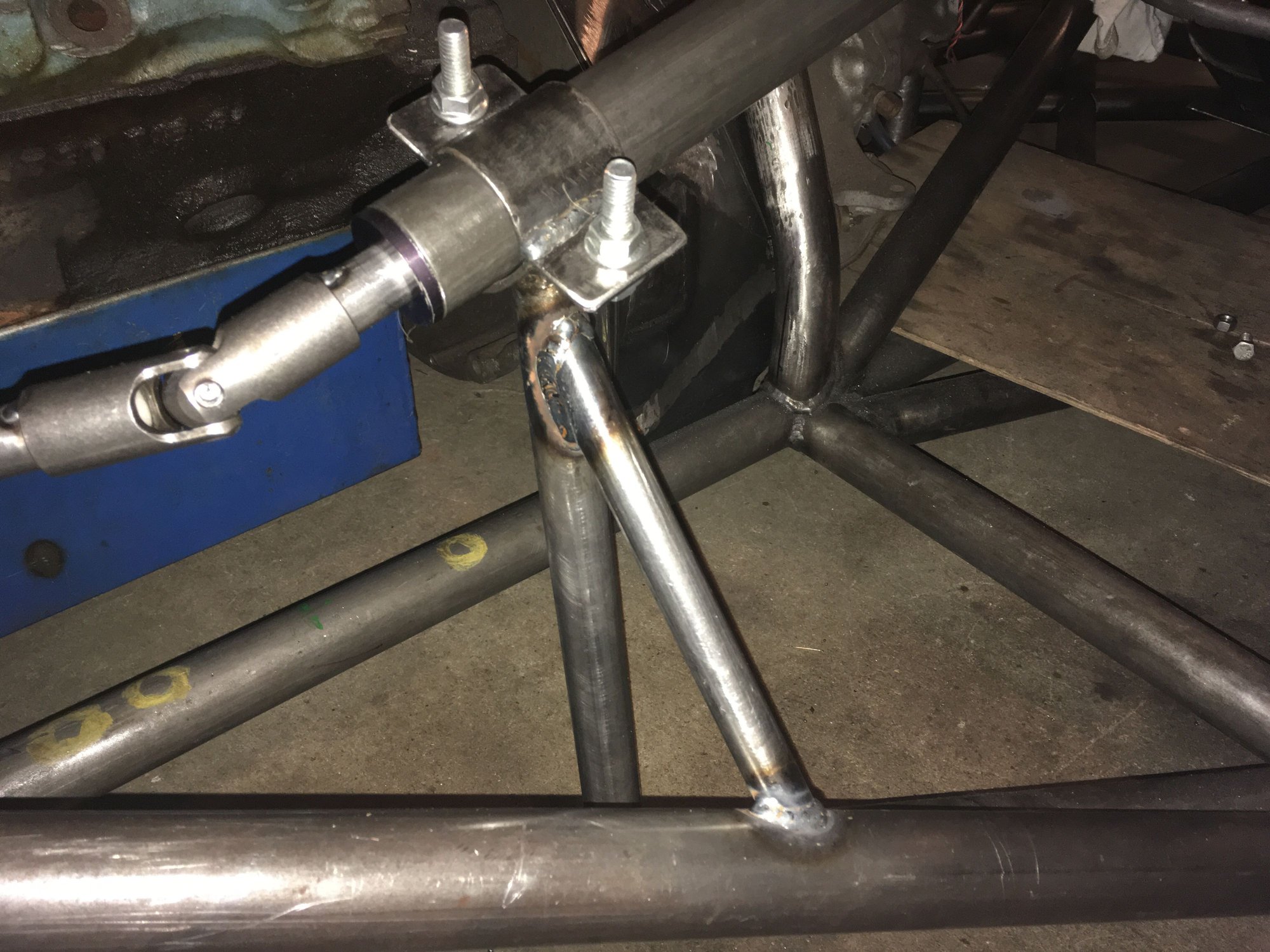

Got steering column mounts done today. Can’t tell if pictures loaded doesn’t show them in preview post. I’m disappointed in new format.

Thanks, some of it may look a little clunky or unfinished which will be taken care of when I do final weld.
Thanks with the picture posting, what worked was not stated in the FAQs when I looked for answers.

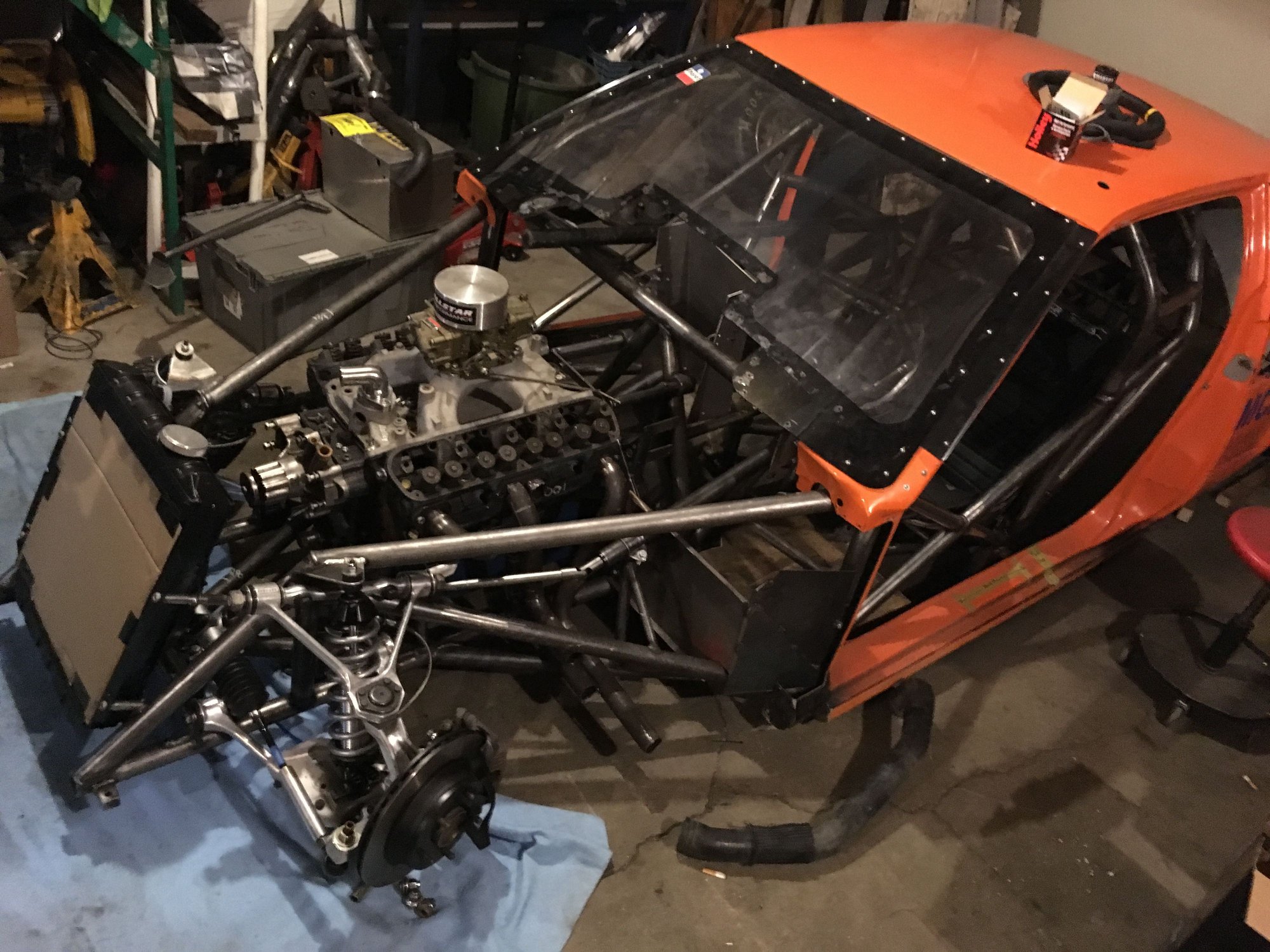

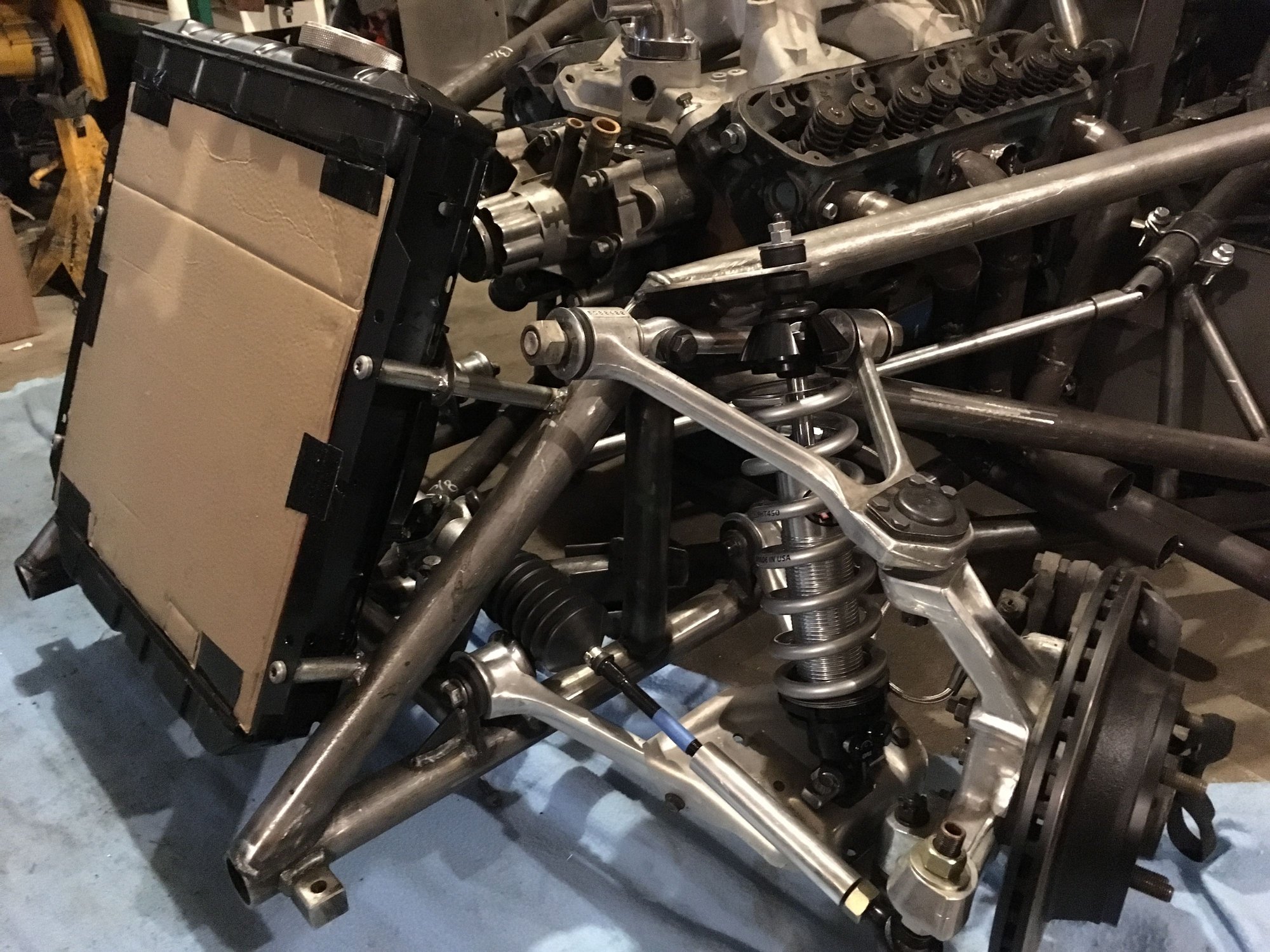

Mounted radiator and fan and have body just sitting on chassis. It’s a 1966 Mustang 289 rad, will buy a nice aluminum one that should bolt right in when we can afford one.
