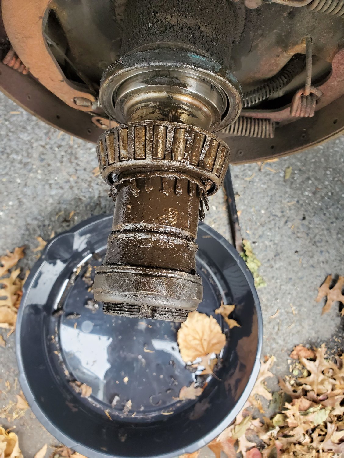

1986 d350 spindle
I have a 1986 d350 srw. I was driving and I thought my brakes locked up. I got it home pulled the tire off and the axle out and the hub and drum slide right off. Didn't even need to remove the spindle nut. The outer bearing wasn't even there. But I'm pretty sure the end of my spindle is pretty messed up. Does anyone know if you can repair or replace the spindle?
Old Nov 10, 2019 | 06:08 AM
Cut the race and see if you can chisel it off....
