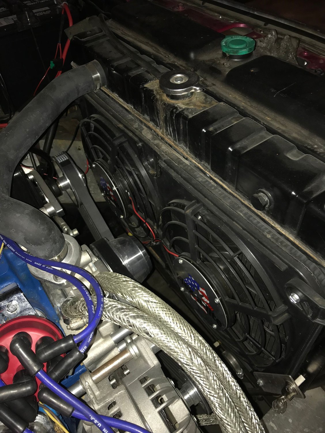

I’m using a duel electric fan to help with clearance for the billet serpentine pulleys. It’s a flex-a-lite puller with an adjustable temp controller. I’ll get some pics of the fan set up when I get home tonight.

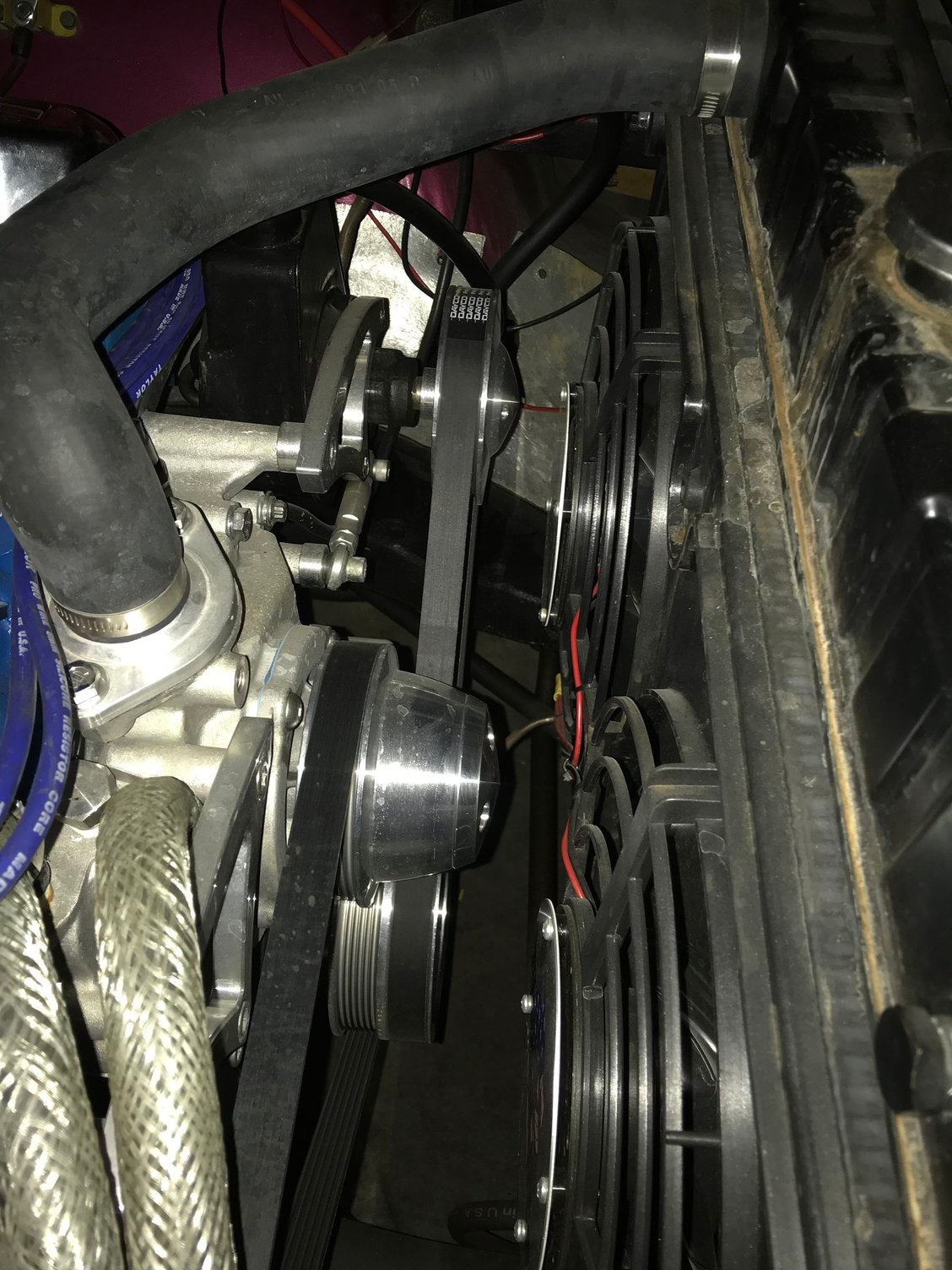

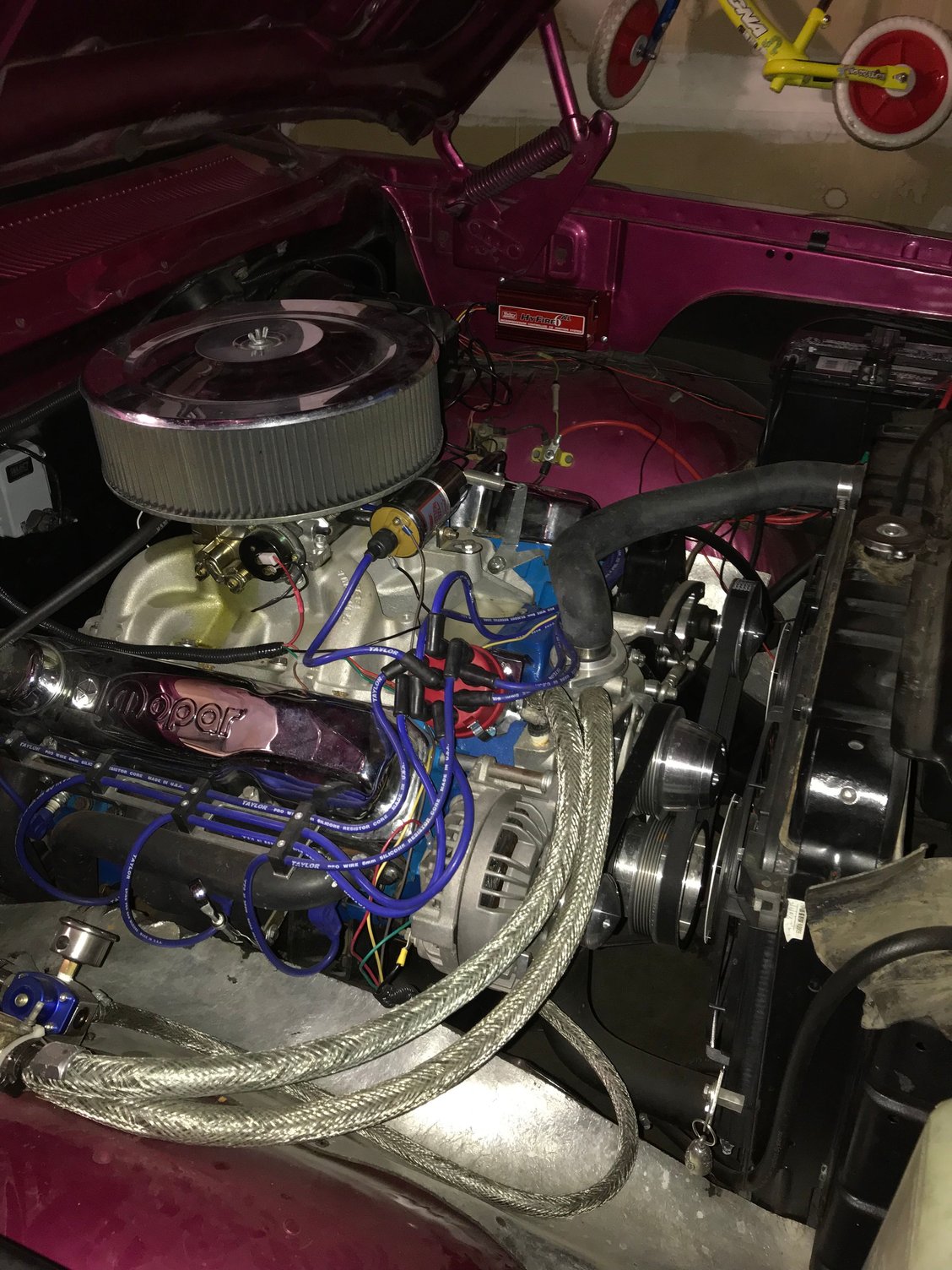

Here she is in her current state, don’t mind the dust, I’ve been working on a couple other projects for the last couple years.
You can kind of see the fans, I have them set to come on at about 170F. They seem to do a good job with the little use I have on them.
This pulley set up is the reason for the duel fans. The single was about 1/4 inch into the water pump pulley. With two they kind of straddle it.
