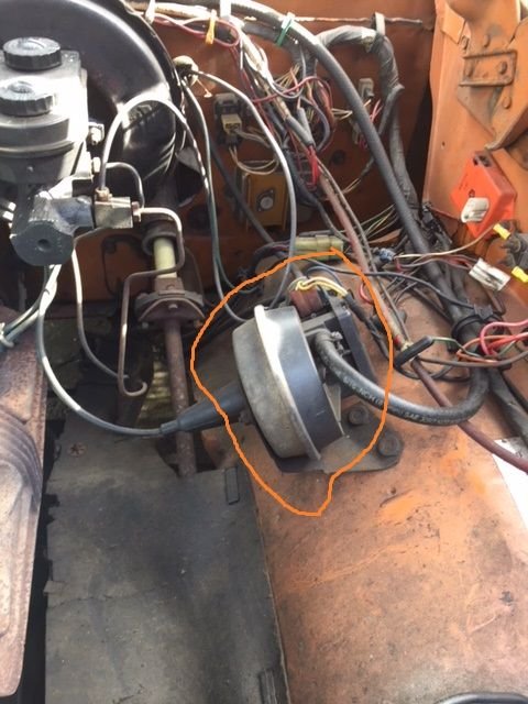

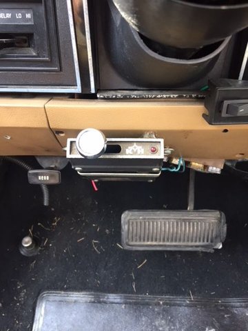

Also I'm wondering if anyone can identify the following firstly in the cab directly below the steering wheel and some how attached to the brake pedal or system
and the other two are under the hood
So if anyone can help I would appreciate it thanks.

Your first question, the device on your lower dash appears to be a trailer brake controller, your picture under the hood looks like a cruise control.
please take a picture of what your talking about on the dash.

My truck is older so I can't help with the dash but I had the same thing below my dash for the trailer brake. I didn't trust it at all and don't plan on pulling a big trailer so I removed it. I think my brakes actually worked better when I got rid of it. I returned it all to stock form and it brakes just fine. Good luck with your truck, welcome to the forum. It looks like you have a really clean project to start with.

Under dash is a trailer brake controller. That can go if your not going to be towing anything.
First under hood is the cruise control actuator.. Should work when cursing down the highway.
Second under hood part, is the Vacuum Amplifer for emission stuff. Like EGR Delay, spark delay, and so on.

At one time some brake controllers were run off the brake hydraulics and would have a hard line to the controller.
Old Dec 8, 2018 | 06:40 PM

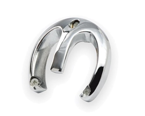

Hey guys my truck has these cool tie downs and I'm missing three from the tailgate. I searched e bay and then did a google search and I cant seem to find them on any other truck. Looking at them I'd swear they would be a Mopar item but they dont appear anywhere. Has anyone seen them before or know whee I'd get replacements
Old Dec 17, 2018 | 06:45 AM
I've never seen those before they look like they would work.
Old Dec 17, 2018 | 07:10 PM
Close as I can find....
https://images-na.ssl-images-amazon....19Lm5SYUWL.jpg

My Dad had those exact same ones on his '70 Ford, he bought them at a retail store in the US called Gibson's. They are out of business now, but they were an after market item.
