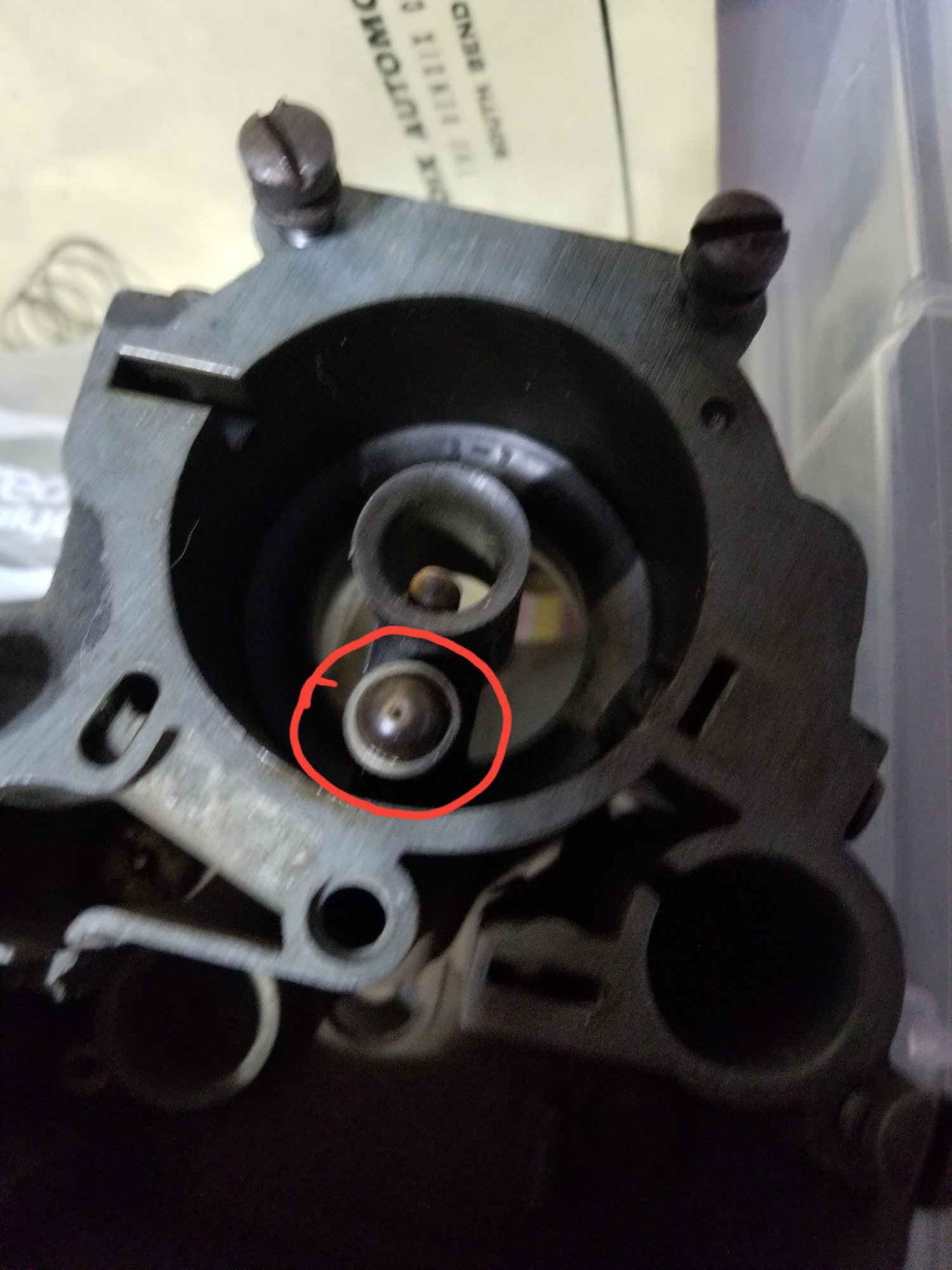

So I got home from work and decided to pull the carb and took it all apart. Turns out the the cold start primer was clogged. Cold start prime was clogged
