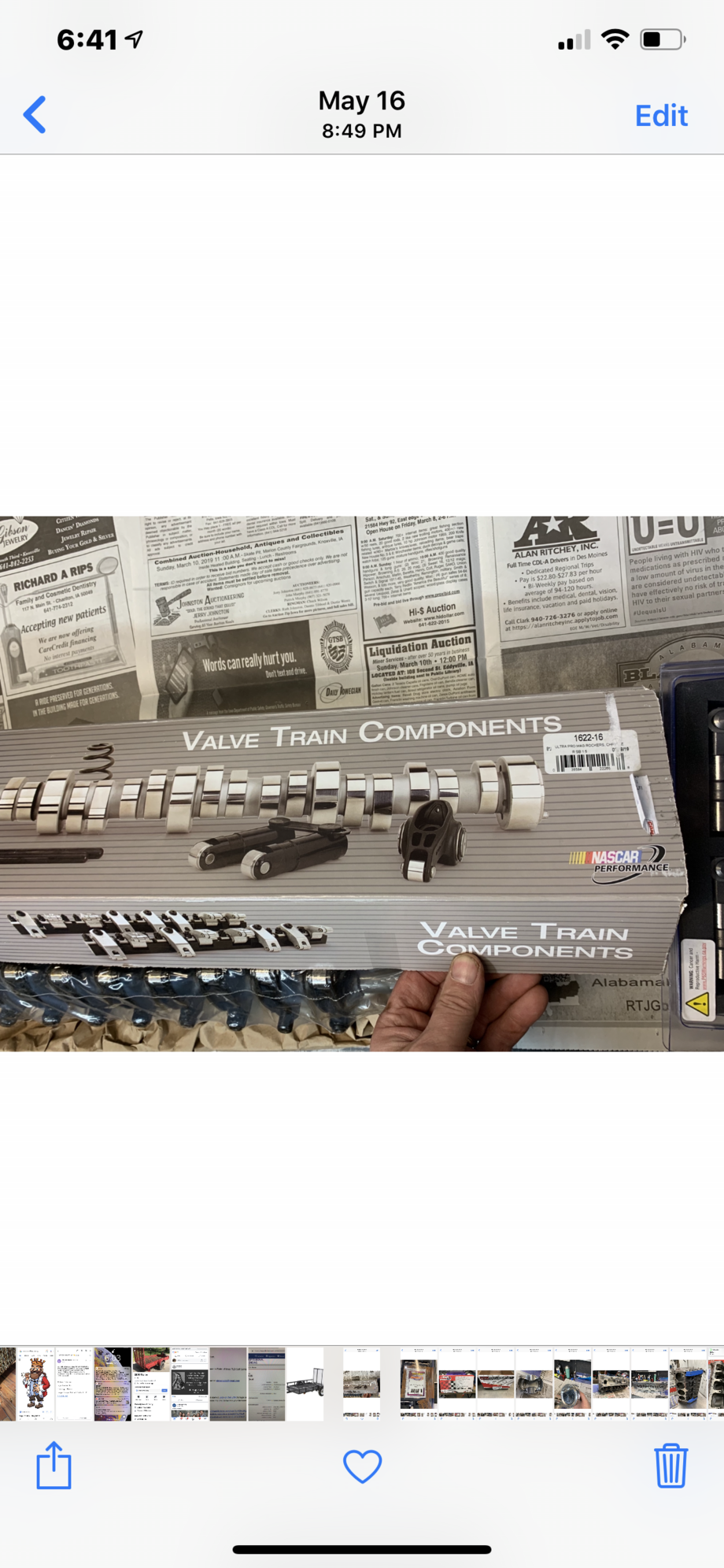

What cam are you using to make the 500-550 hp?
Old Jun 11, 2019 | 04:55 PM
Del Stevens's Avatar
Joined: Jun 2019
Posts: 7

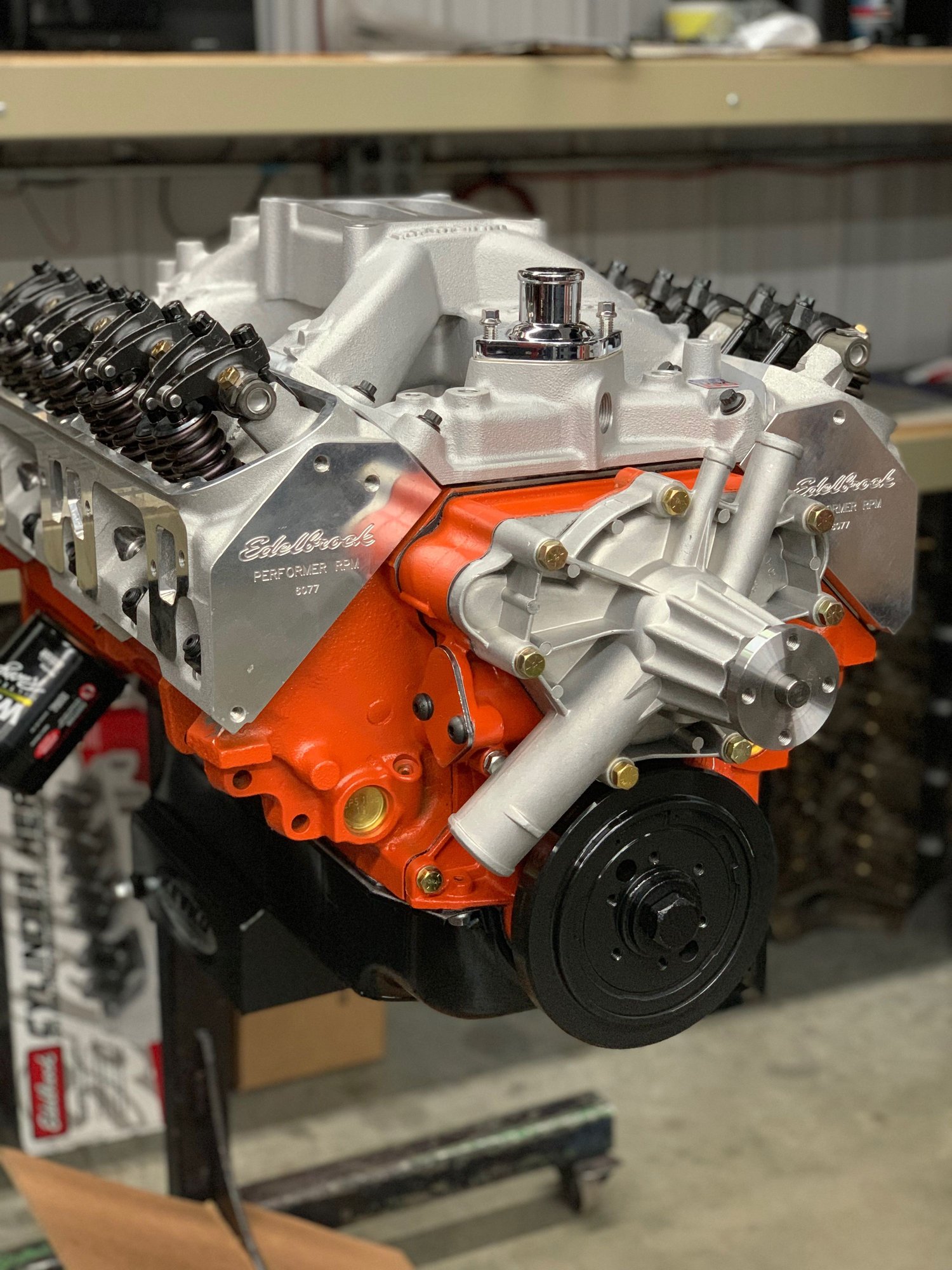

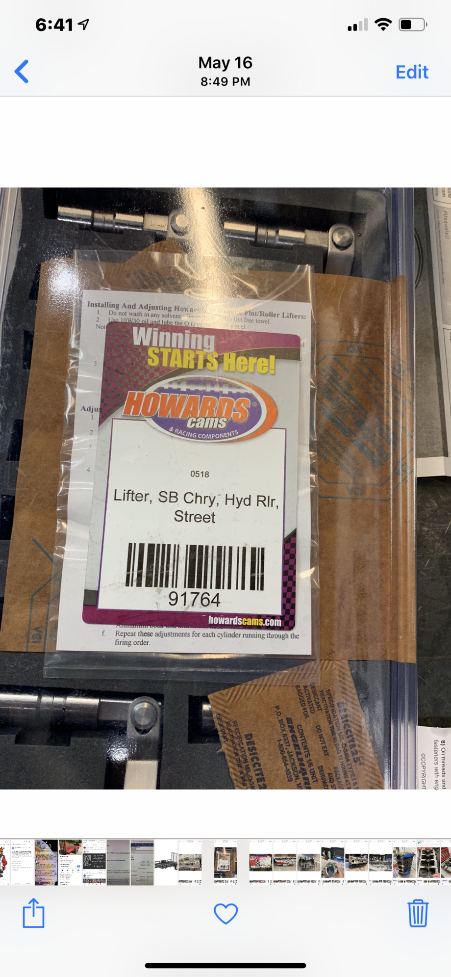

Just following my mechanic I think it will be closer to 500, photos of parts.
Old Jun 11, 2019 | 06:03 PM
I can't read the cam numbers could you please post them?
I need to ask him
Old Jun 13, 2019 | 02:39 PM
https://www.summitracing.com/parts/cca-1622-16

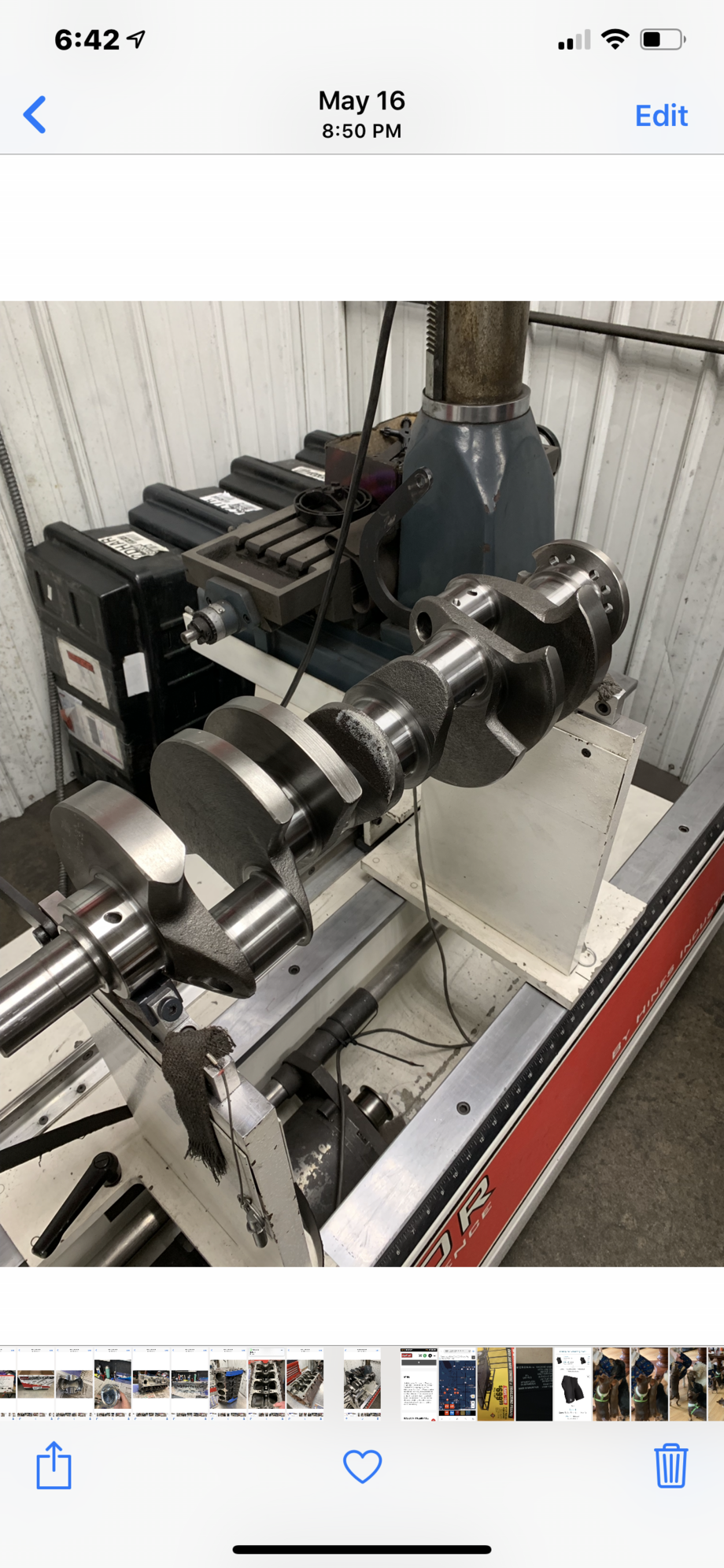

I just noticed that piston with 1.457" compression height is for a 4" stroke crank 408 c.i., looks like a cast crank too. Calculates to 9.7 c.r., sound about right?
We added a scat cast 4 inch stroker, mechanic was thinking better metal than a few others with APR studs. The cam was custom still need to find more detail numbers were not on my billing sheet.
