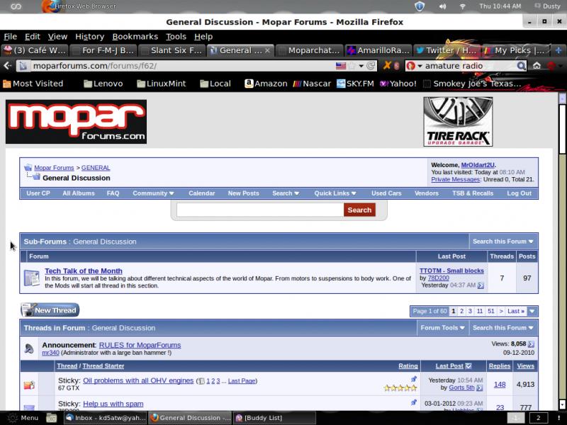

changing the subject how do i post new thread i cant find the tab on the sight here also why doesn't my photo appear when i make a reply ?????????????
thanks

Not for sure pic you are wanting to show? A signature pic or a avatar? Info on avatar is here https://moparforums.com/forums/f62/p...pictures-2128/ and this is where my new thread button is:
Upper left below my cursor arrow
