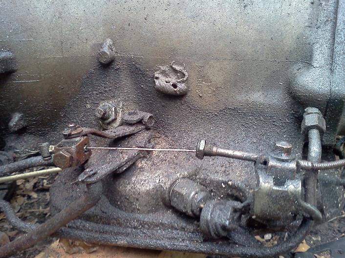

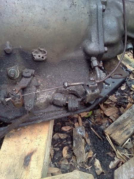

i will post some pictures for a cable set up my brother made for his trany

this is a choke cable he used with some other parts for his kick down you ll recognized some parts
ok, tx for the pics i just heard from the shop the tranny is shot and needs rebuilt, I'm getting it rebuilt and i need a new converter so I'm changing it back to a fully automatic the shifter can be used but I need the kickdown linkage which I'm sending for from Bouchlinn's should be all done by next week
