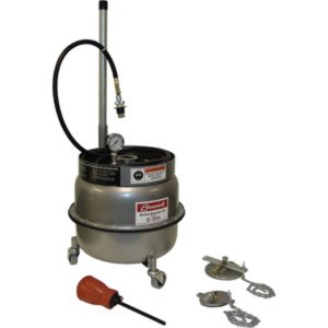

If that dose not work.... Try a power bleeder
Been using a pheunmatic bleeder

I don't like gravity bleeding. I just don't. I've dealt with several situations where POSITIVE PRESSURE in a system is a good thing. Gravity bleeding puts NEGATIVE pressure on the system
How "handy" are you? I've built pressure vessels---you are only talking about a few psi, here, plumb the pressure vessel into a front or a rear line at the master, and force fluid through to the wheels, to both force out air and to flush out debri/ old fluid
Make sure the master has been bled. With the system bled and the shoes tight, you should get a high, stiff pedal, and with the pedal held down hard (someone watching) you should get spurts back out of the master. Careful here, you can get fluid all over painted surfaces.
