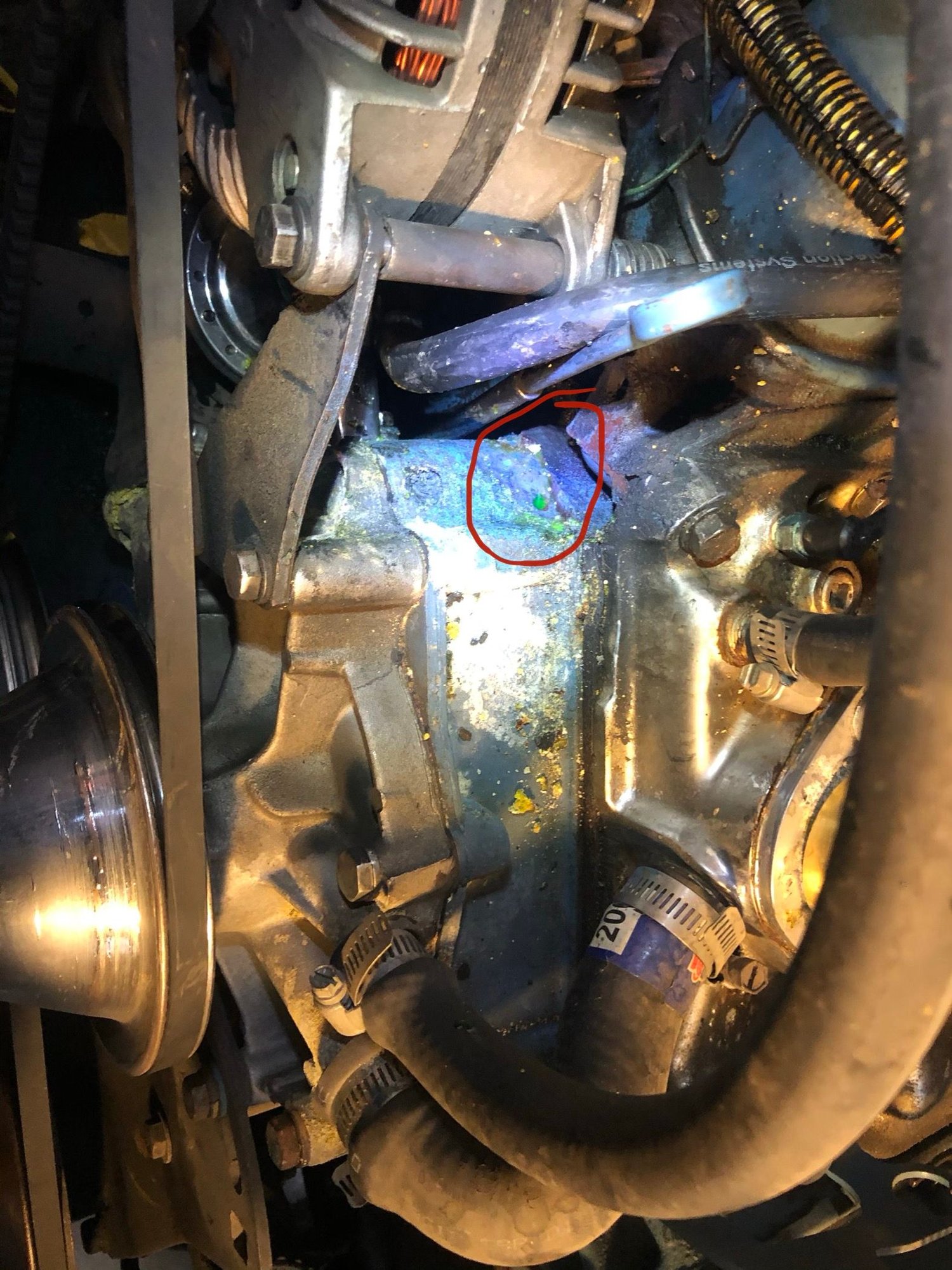

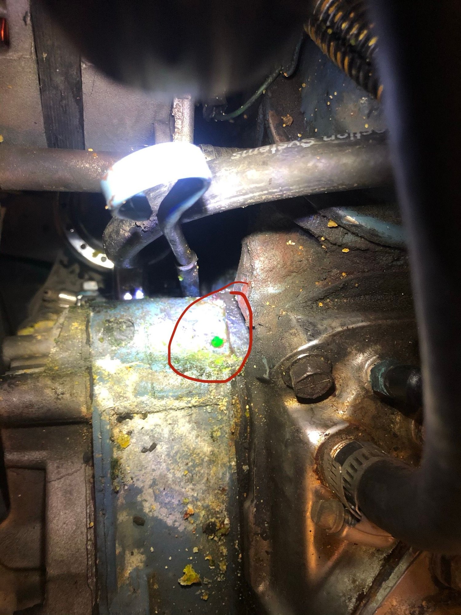

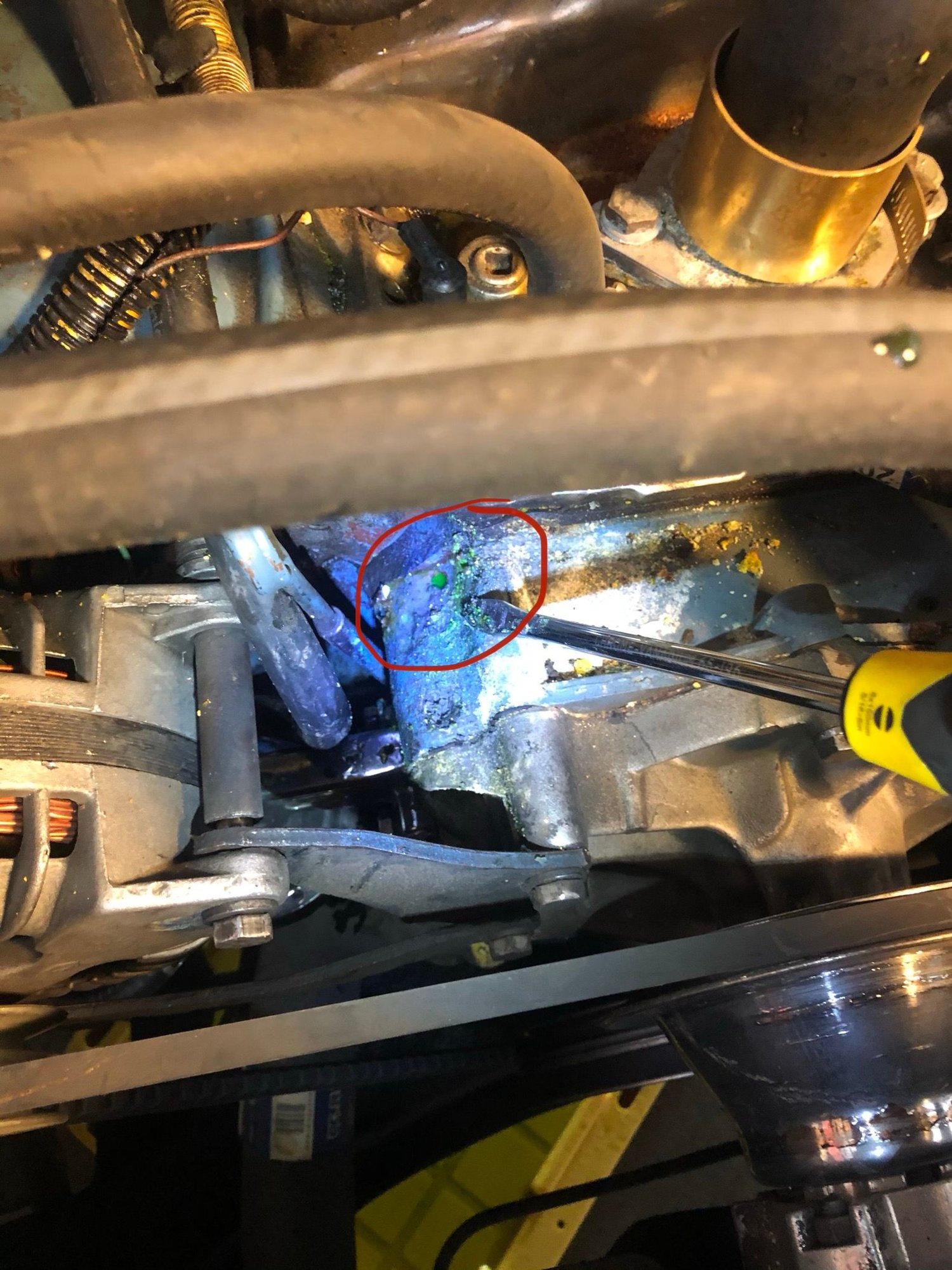

Hello. I am restoring a 1973 Dodge Challenger, 340 4 barrel, with my teenage daughter, and we just got the engine to turn over after replacing-oil, oil filter, spark plugs, spark plug wires, ignition system, fuel filter, fuel pump. While we were doing our happy dance, the engine started to spew coolant from a hole near or on the engine block, between the belts and the main block.
Photos of it on this are attached. Red circle indicates where hole with leaking coolant is located.
My question is: Can someone verify from the photos/image that this is in fact a hole in the upper part of the engine block, and that our project is now over? Or is this a part of the engine that can be replaced while keeping the same serial number engine block?
Thank you in advance!

You need to replace the Timing Cover....
Good little project... Keep chipping at it....
