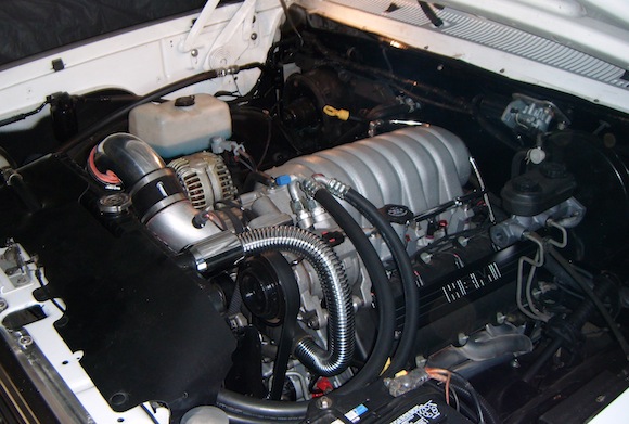

I note there has not been any recent comments on this thread so I thought I would share a swap that I've just completed. Originally a 318 swapped to a 5.7 Hemi

To do a easy swap in a 78-down with A/C you use a Professional Products Crosswinds Intake
To do 79-80 you use the A/C compressor & hoses from a 78- down
Attached Thumbnails 5.9 L into a Ramcharger-sam_3363.jpg   5.9 L into a Ramcharger-sam_3674.jpg
