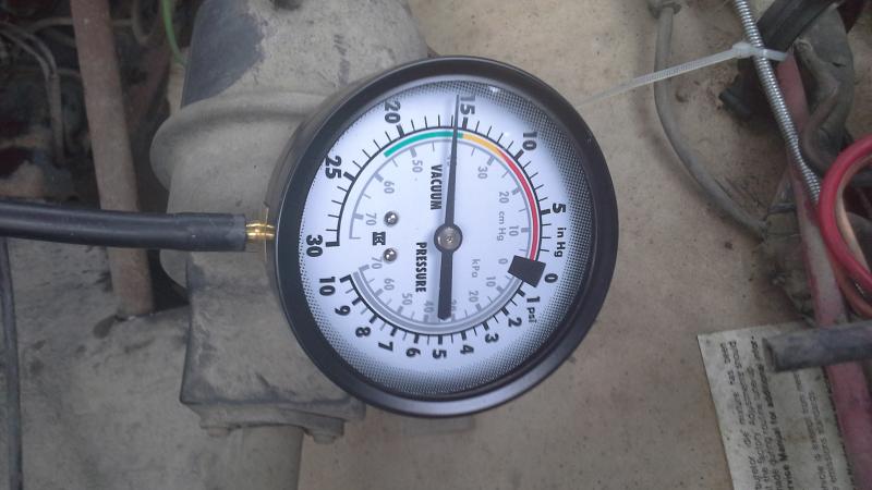

Ok so I just got back inside took some pictures of the vacum gauge. If I know how to read timing right at idle I am at 10 degrees btdc at idle.
This is where it was at once it warmed up

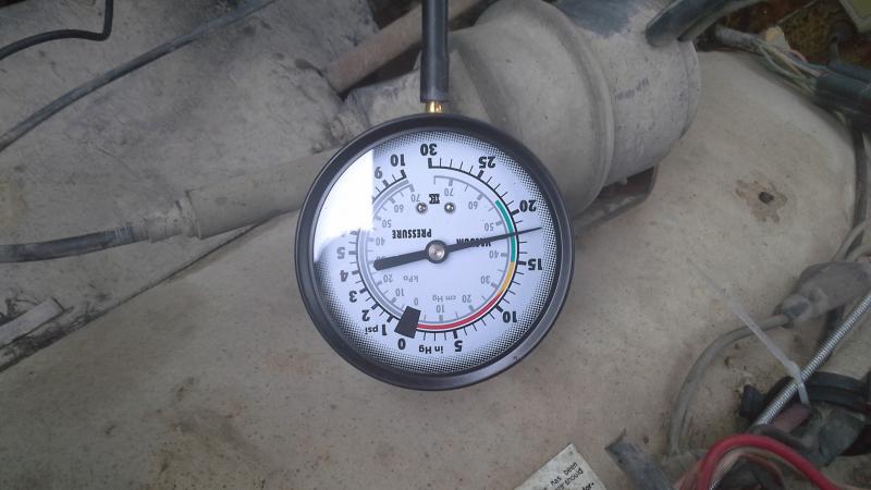

This is were it was at after about 5 more minutes.

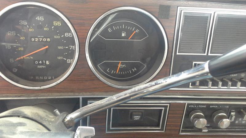

Is my oil pressure to low? If so how do I fix it? I have 5w 20 In it I belive?

Vacuum is file...
Oil With 95,000 + miles you need a heaver engine oil. Moe like a 15W40 or just a straight 40W, (Depending on your location And Climate). That will help the oil pressure a little from all the wear in the engine.
Engine need a good pressure washing...
