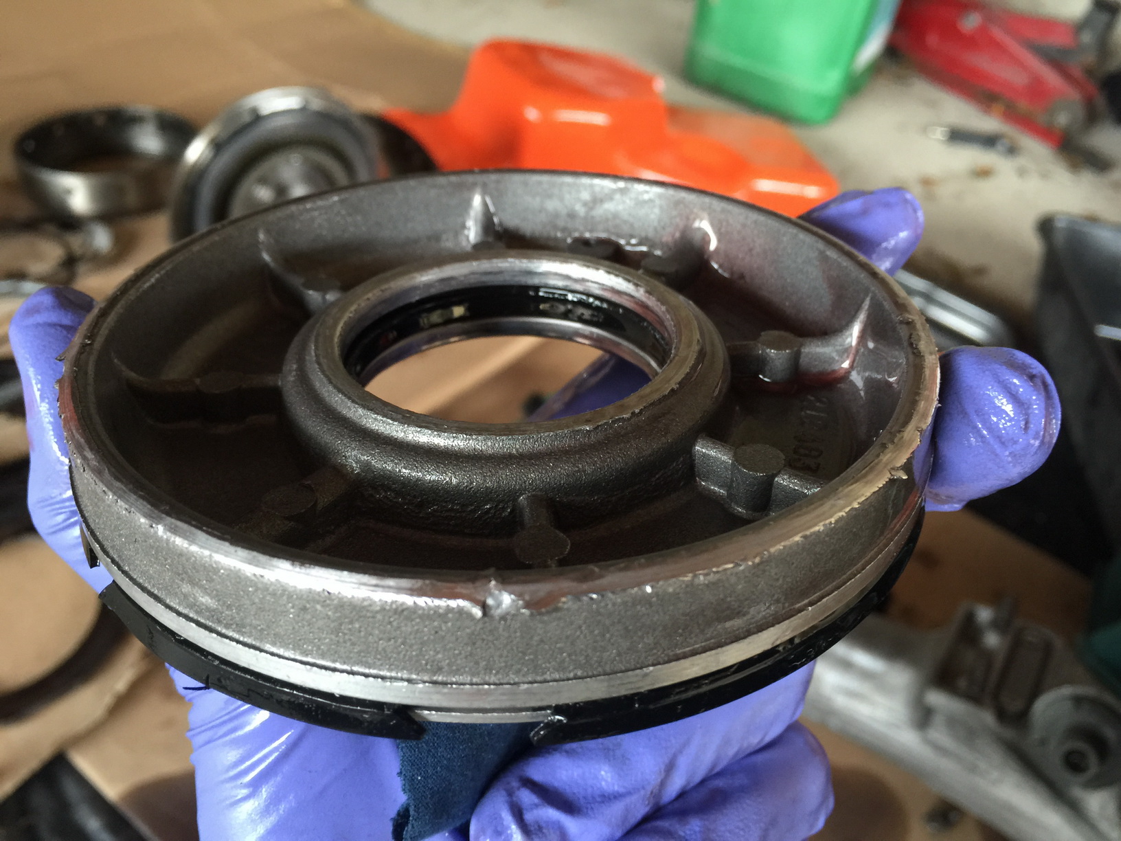

The piston seal is damaged. Piston also have damage. Can be a assembly fault in rear clutch piston ?

The bellville spring (first picture )(16-425-5 in exploded view)is in backwards/upside down! And obviously the seal is pooched.
when installing the piston , use a twisting /turning motion to get it in smoothly(with lots of lube)!
