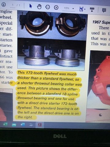

The first thing to check is to make sure the bellhousing is correct for the hemi engine you have. The bell housing stamped number should be 2780512 and the flywheel should be 172 tooth. Also check the casting number on your trans, early casting #2466416 and later casting #2801176. This might help identify what you have before you spaek with Brewar's. I have my hemi engine out right now so I can't answer your question. But Brewar's Performance should be able to answer your question. Also the throw-out bearing (see photo attached) is "shorter" on the hemi with the A833 trans than other engines. The Hemi set-up is unique. Good luck, sounds like the truck would be a screamer!
