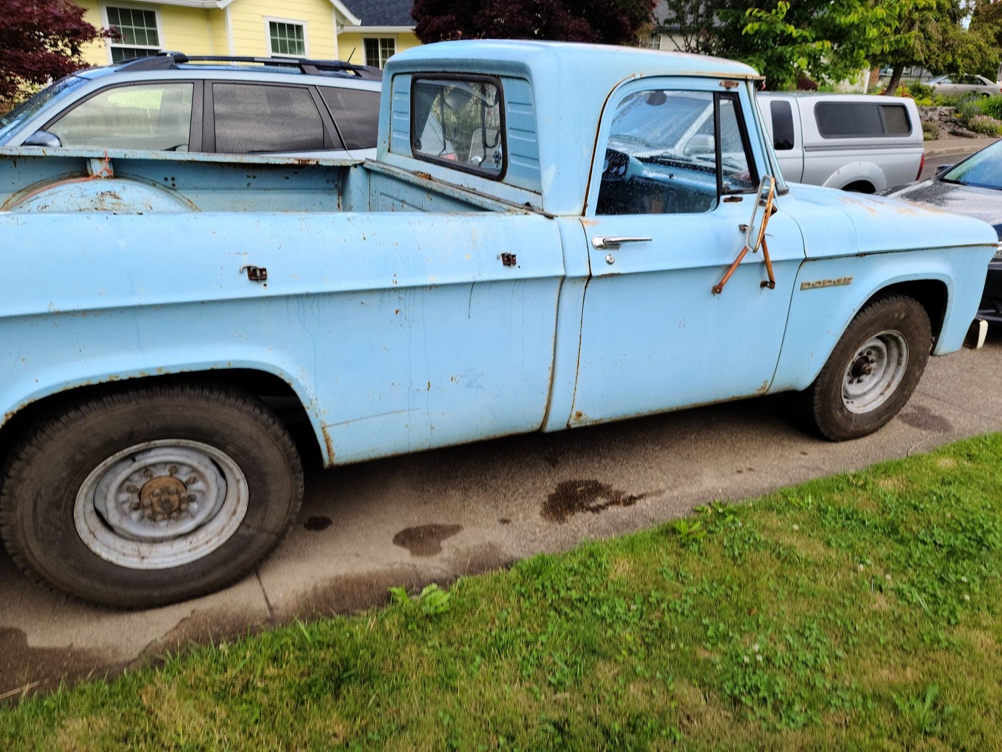

So you can see what you've been assisting with
