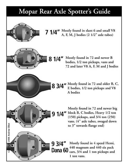

Here is what most MOpar rear axles will look like. Doesn't mean that someone could have swapped it out for something else though.

Thanks for the reply Cant seem to read numbers and letters or make much since of what i see. May just have to take it out this winter,and then figure it out. Thanks

Thanks for all the replys I am now sure it is not a mopar rear end. Just got it up on jack stand tonight will get pictures, and more info and try again. I am almost sure it is a ford. Just not sure what it is out of doesn't look to have been cut down.
