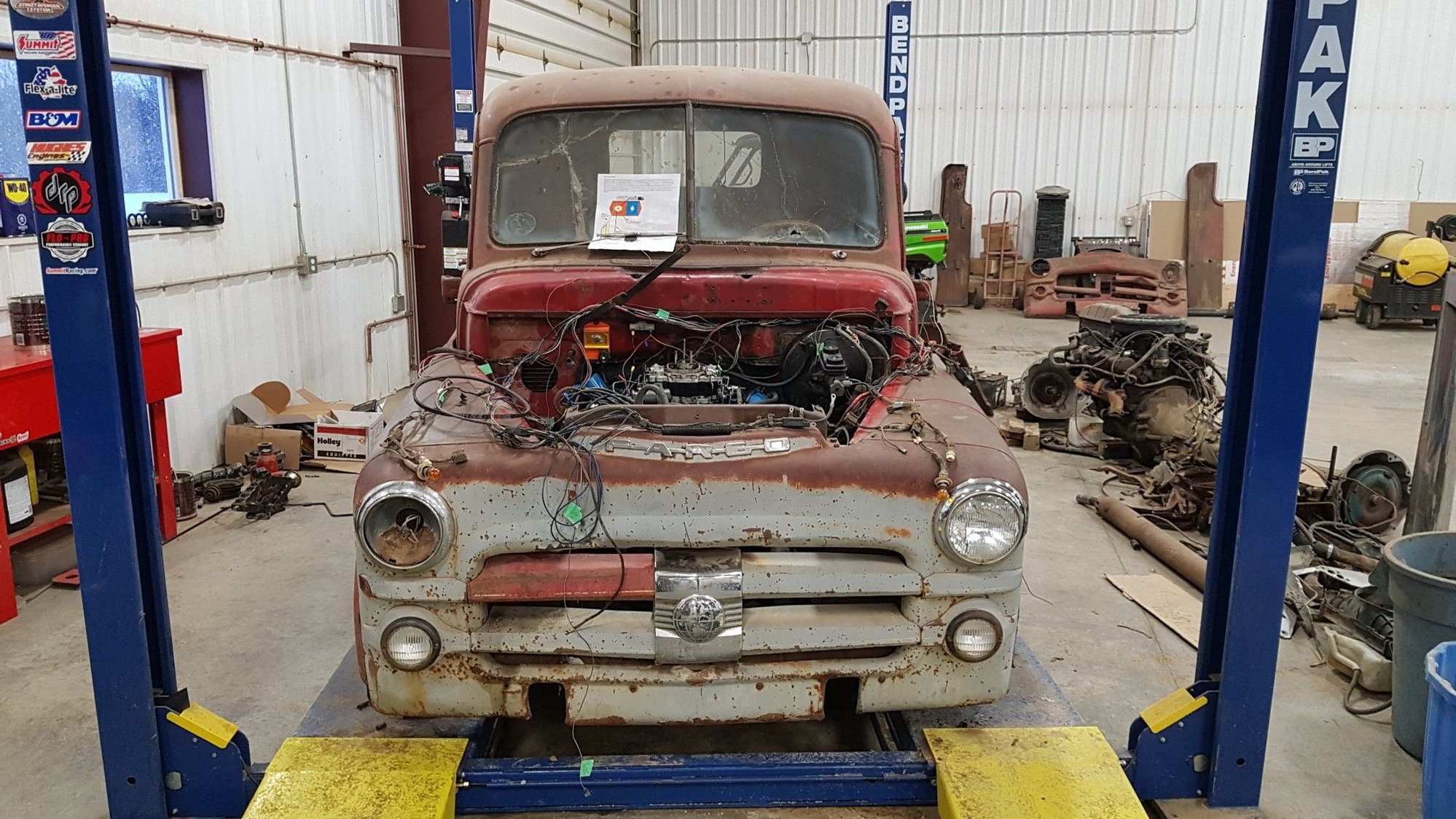

I'll post some truck pics in another post
Old Feb 20, 2019 | 09:19 AM
f_armer's Avatar
Joined: Feb 2019
Posts: 6
Some pics
of truck
