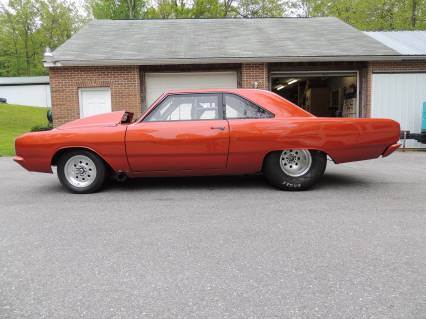

The car is incredible condition. Its been built as a street/drag car. Everything on the car, paint, undercarriage, and backend are brand new.

Paint looks good... Hate the COWL hood

Car looks good. Definitely looks more strip than street. I'd be curious to know how "streetable" the car is? Does it overheat on warm days on the streets? Compression ratio, rear gearing... How bout time slips from the owner?
If you're looking for a "Weekend Warrier" this may fit the bill.

That's a photo of a full on drag car. You can see the full halo cage, lexan windows, slicks etc.
It will not be an easy to drive/or easy to convert to, a street car.
The engine is probably something they dropped in to replace the race engine, for the sale.

The shorty headers coming out under the front fenders is also a give away its not street legal.. I agree Bob the bath tub has to go.lol ...Bill
